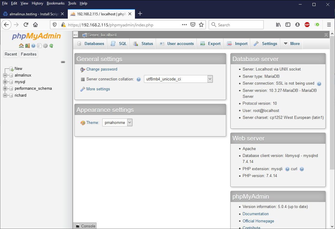

More things that worked “out of the box” with no drama:
Updates happened on schedule.
phpMyAdmin installed with no errors.
CSF installed with no errors.
Restore From Backup succeeded with no errors. As a combined test of Restore from Backup, PHP 7.4, Apache, and MySQL, I “restored” a backup of a database-driven site that compiles blocklists of malicious IP addresses. It succeeded without errors.
I haven’t done anything with the mail yet because it’s a local server on a self-signed SSL and I can’t get PTR to this IP. I guess I can set it up and telnet to it from the LAN to get some idea whether it’s working or not. Or maybe I’ll spin up a VPS at Turnkey to play with.
Long story short: Everything about AlmaLinux that I have tested has worked. I haven’t had much time between work and the almost two feet of snow; but so far, this still looks very promising.
If anyone has an extra computer and extra time on their hands, maybe consider spinning it up and playing around. The more eyeballs looking for bugs and the more feet stomping them, the better.
Richard

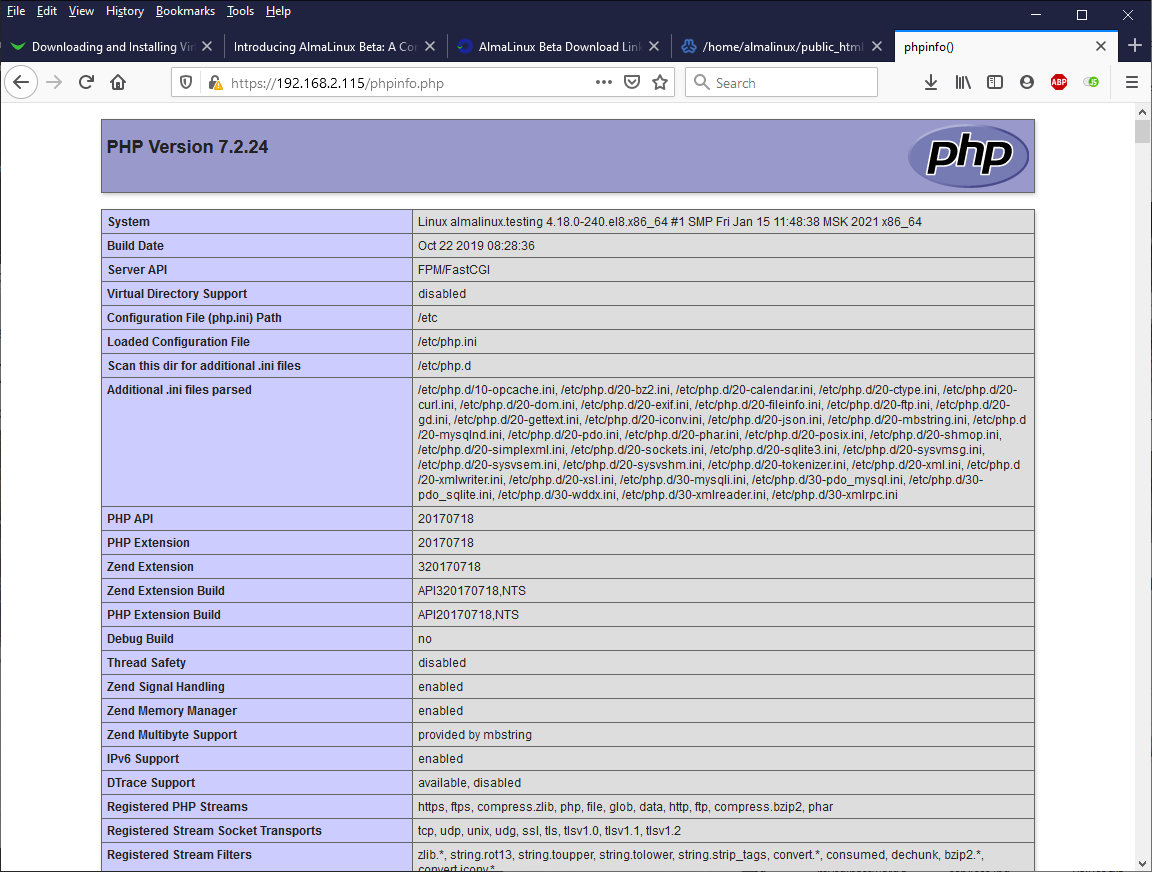

So I’ve had the first hiccup since starting this test. I’m not sure it had anything to do with the OS per se, but it’s worth mentioning because it may have broader application.
When “restoring” a WordPress site from a Virtualmin backup, the needed PHP extensions were not enabled. I knew how to manually enable the extensions; but just as an experiment, I decided to create another WordPress site on another domain using the Script Installer to see if that enabled them. It did. However…
The testing server has PHP 7.2, 7.3, and 7.4 installed, with 7.4 being the template default. But when the installer couldn’t install the gd extension on 7.4, it enabled it on 7.3 for the temporary WordPress site. I changed the PHP version on the restored site to 7.3, as well, which fixed the extensions problem.
I haven’t had a chance to figure out why gd wouldn’t enable on 7.4 yet. It appears to be installed. I’ll poke around some more later on today.
The site that I used as a test had originally been created on a cPanel server on CentOS 7, then migrated to a Virtualmin server also running CentOS 7; and restored to a testing server running Virtualmin on AlmaLinux 8 (but which has been slightly hacked to impersonate CentOS 8) from a backup made on Virtualmin on CentOS 7. So it could have been worse. I’m mainly curious about why it couldn’t enable gd on PHP 7.4.
That is all. Carry on.
Richard
