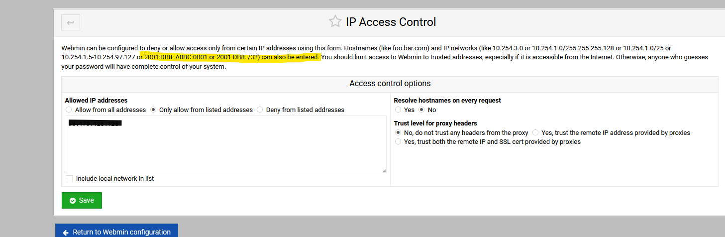

Hi, my ISP provides me with a Ipv4 and an ipv6 IP. Periodically, the ipv4 expires and I get a new ipv4. The ipv6 seems to be static.
Whenever this happens I can’t log into webmin as i have enabled IP Access Control. Webmin rejects my connection on ipv4 - it doesn’t try ipv6 even though the ipv6 is OK and matches an IP in Access Control.
Is it possible only to allow ipv6 connections to the webmin control panel? I can see an option in Ports and Addresses to “allow ipv6” but nothing that prevents ipv4.

On each server I have restricted webmin IP access control to the ipv4 and the ipv6 range (/64) like this (ips shown are not real)
2a02:ded:da32:3222:0000:0000:0000:0000/64
1.234.567.89/32

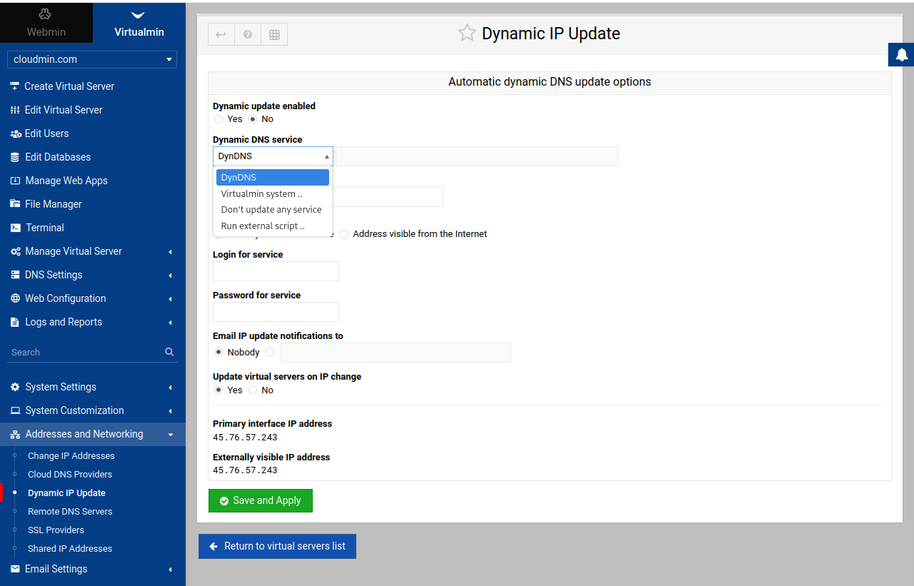

I would assume that there is dynamic dns update functionality in virtualmin/webmin but I have no experience with it.
Virtualmin supports dynamic DNS update in a variety of ways:
Hi I am not sure how Dynamic DNS helps with my original query - apologies if I have misunderstood how it works. My servers have static IPs that do not change.
All I want is for webmin to allow ipv6 connections to the control panel using IP Access Control when ipv4 fails because my broadband ipv4 (non-static) IP has been changed by my service provider. The ipv6 address my broadband provides is static so does not change when I reboot router, etc.

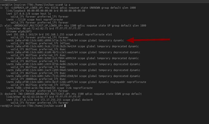

perhaps not relevant, but I set up a quick site and found that over a few hours my ipv6 address altered so my ipv6 address changed to one of the deprecated addresses and later back again.This may be a quirk of the network & router I use so my be of no use to you but others reading this thread may find it useful
