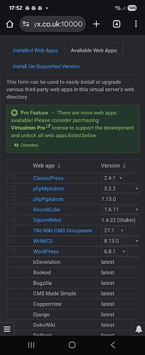

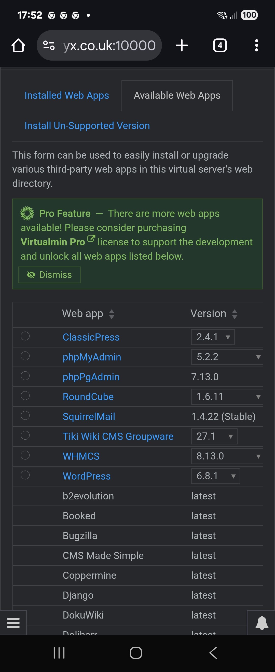

Nope it’s there on the webapps screen alongside phpPgAdmin. (I’m using GPL.)

Turns out there are two places to manage web apps. Visibility got turned off in one. :confused:
Where’s the other one?
I think one is meant more for the domain owners to see.
That’s how I see that one. One is for the Web Admin and one is for the system admins to choose which ones are available.
