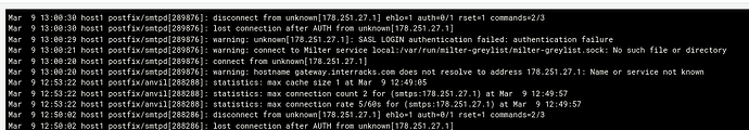

However, sending mail back to that adress results in errors. The log shows:
Mar 7 18:10:43 host1 postfix/smtpd[124505]: disconnect from unknown[178.251.27.1] ehlo=1 auth=0/1 rset=1 commands=2/3
Mar 7 18:10:43 host1 postfix/smtpd[124505]: lost connection after AUTH from unknown[178.251.27.1]
Mar 7 18:10:42 host1 postfix/smtpd[124505]: warning: unknown[178.251.27.1]: SASL LOGIN authentication failed: authentication failure
Mar 7 18:10:39 host1 postfix/smtpd[124505]: warning: connect to Milter service local:/var/run/milter-greylist/milter-greylist.sock: No such file or directory
Mar 7 18:10:39 host1 postfix/smtpd[124505]: connect from unknown[178.251.27.1]
Mar 7 18:10:39 host1 postfix/smtpd[124505]: warning: hostname gateway.interracks.com does not resolve to address 178.251.27.1: Name or service not known
I suspect that name gateway.interrracks.com is from my ISP’s datacenter. I have no clue as to why any mailserver out there would want to send it to that url. It continues to use that router IP ending at .1 which I still think is where some of my issues come from.

That gateway.interracks url is from my ISP, the IP address …27.1 of my router. Indeed, that won’t resolve there and isn’t supposed to. Although everyone is telling me that virtualmin using the .27.1 address as a router, I feel this is where it goes wrong. I´d prefer if virtualmin would completely ignore this .27.1 IP.
