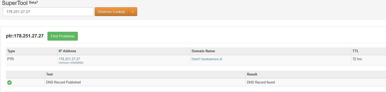

you now have no ptr record you need to set that up
But where. I figured since itâs complainign about the IP, and the IP is supposed to point to host1.hostservice.nl, I added these:
First only with mail.host1⊠that didnât work so I added just host1âŠthat doesnât work either.
But all this is setup in the DNS settings from the server that runs hostservice.nl. (Server A in the initial post)
The ptr record may only be able to be edited at your provider and not via virtualmin/webmin depends on your provider
In principle I can control everything. Both the provider at the DC issuing the IP series to me as well as the hosting provider where (temporarily, until we get virtualmin working) a couple of domains and websites are running incl hostservice.nl
Thereâs two things I notice; first of all Gmail is reporting the IPv6 address as the address without PTR, am I seeing that correct? I can remove all IPv6 references on the host1.hostservice.nl domain if that helps.
Secondly, I would think that both IPâs point to the virtualmin instance that listens to host1.hostservice.nl. I can imagine the PTR records need to be at the virtualmin side? However, the virtual server that was created for host1.hostservice.nl doesnât have DNS settings (anymore). Would it make sense o enable DNS again on that virtual server?
