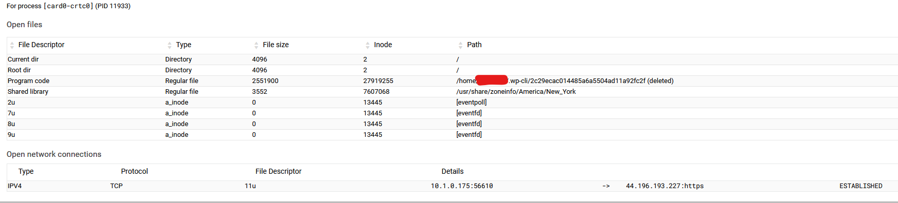

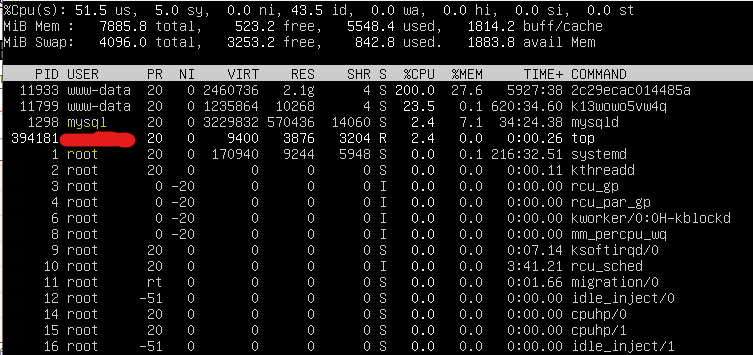

Hi all. Although I have a bunch of Webmin installs running perfectly fine on a variety of servers, I have one Virtualmin instance that has me scratching my head a bit. It’s running fine, as far as I can tell, but according to running processes I have one process reporting CPU usage of 198% which is obviously impossible.
The details are:
command [card0-crtc0]
parent process: /sbin/init
user/group: www-data/www-data
The Ubuntu server is a virtual machine and has no need for video other than command line console.
I’d appreciate any ideas on what’s going on. It’s hard to monitor true CPU usage with this potentially phantom process showing an impossible figure. I don’t want to screw the pooch by digging into this without simply running it by the collective mind here first.
Thanks.
That’s what top reports from the console so it looks “legit” but makes no sense to me.
I don’t think, but will stand corrected, Webmin/Virtualmin also have no need for video. So where has it come from? What/Who installed it? Could it be a simple stop the process and remove whatever is starting it?
A command named “2c29ecac014485a” looks legit, to you?
That looks extremely suspicious to me. I would assume you have an exploited web app running a cryptominer, or some other nefarious something.

As I think it through this morning, it appears that this isn’t a virtualmin issue (specifically) but more of a general Linux issue. A month ago I had a web site get exploited via a WordPress plugin. I’m fairly certain all the malicious PHP files are gone but the fact www-data was accessing card0-crtc0 and then trying to access a since deleted file:
/home/userxyz/.wp-cli/2c29ecac014485a6a5504ad11a92fc2f (deleted)
Is worrisome. I’m an experienced IT systems admin/consultant but my linux expertise is, say, intermediate but getting better every day!
