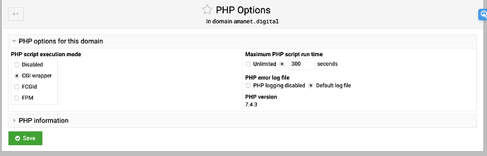

Which execution mode are you using? If you aren’t using FPM, try switching to FPM. If you are using FPM, try switching to another execution mode (e.g. suexec+fcgid) just to test to see if it behaves differently.
Execution mode is in Server Configuration->PHP Options for the domain.

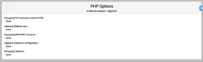

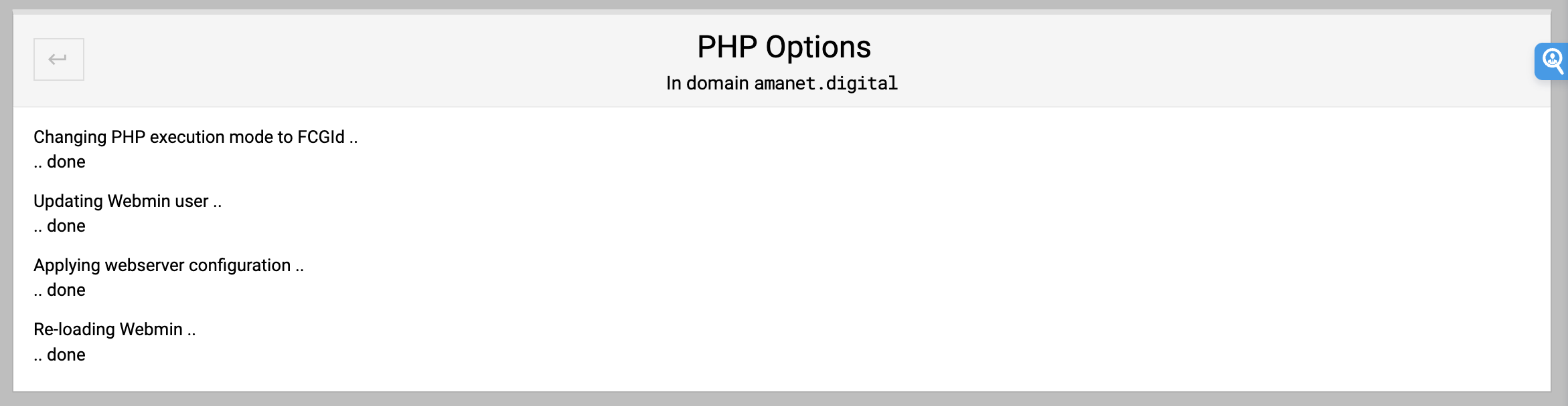

No, I mean, switch execution mode, and then test the site to see if the error goes away or is different.
no same error even I tested them all
