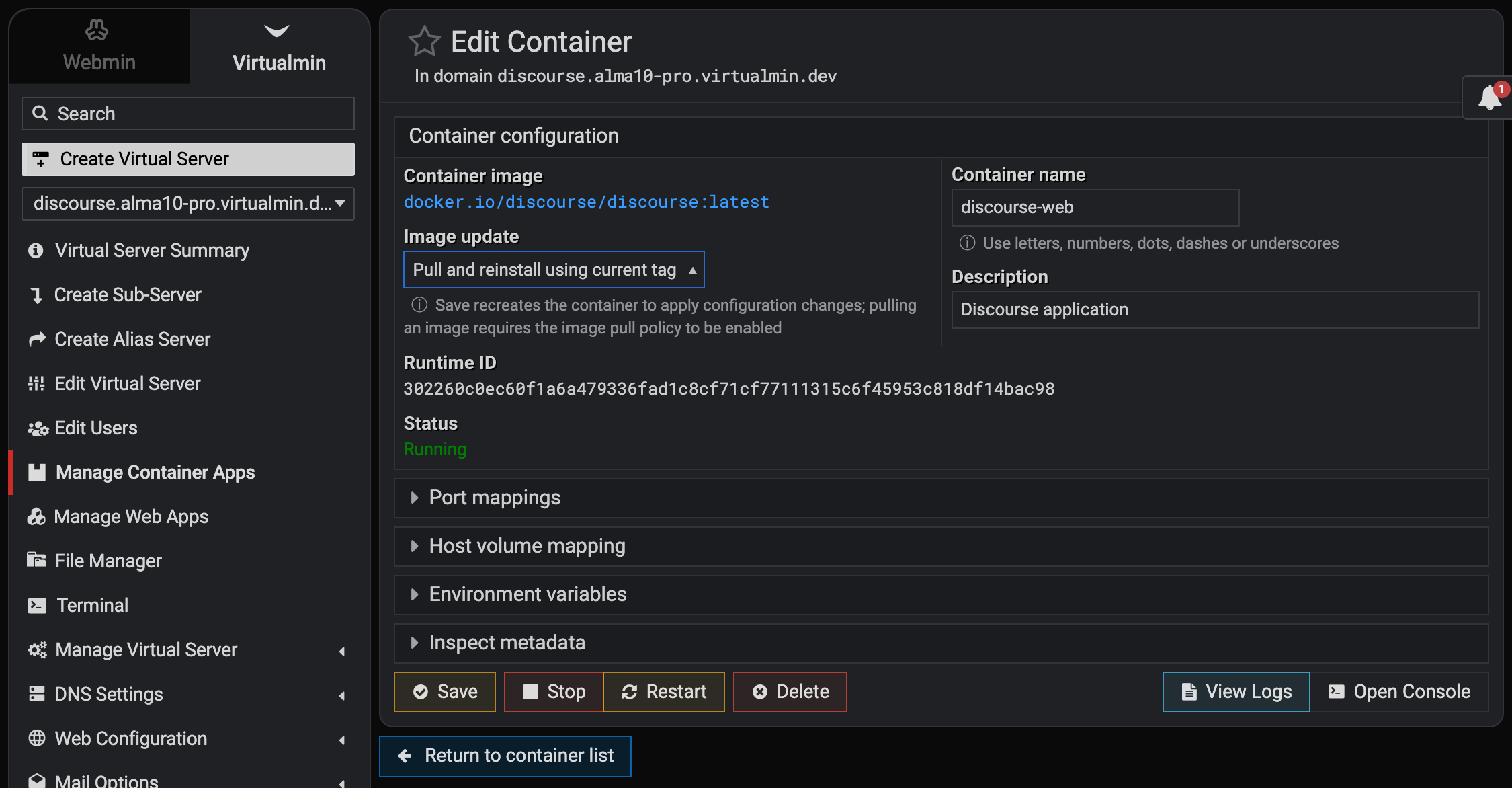

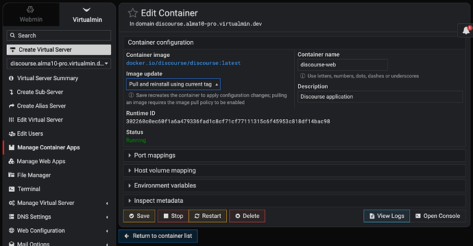

where do I update the containers? in portainer there is a notification icon whenever a new image can be pulled and then you can recreate the container with the same settings but as an update.
We don’t have notifications for this yet. However, you can update it by reinstalling it here:
