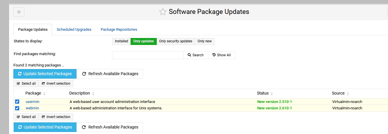

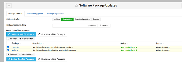

Webmin 2.6 not available yet
Alma Linux 9.7
Webmin 2.520
I never have to worry about available software updates, I always am being informed when there are new ones and proceed always from Webmin.
This time, because I’m receiving “WARNING: MYSQL_OPT_RECONNECT is deprecated and will be removed in a future version.” emails every 5 minutes, I found there’s the version 2.6, not available from Webmin Packages updates here.
