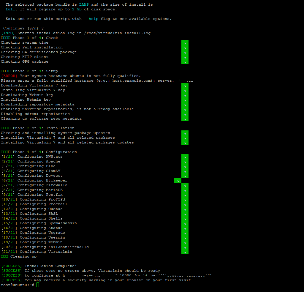

BUT: my server doesn’t have IPv6 and virtualmin worked out of the box.
Just tested on clean OS with no IPv6, no issue. You may need to do a fresh install again seeing this is a new system as its not a issue with the script.

Congratulations, good luck
I have to admit that is not something I run on a new box provided by DO or Linode.
I just accept it as a “clean” install. If I then want IP6 they provide it and I just use it but nearly always after I have installed Virtualmin on the box. I have just assumed that when I get the box it is without IP6 (this must also be true as I have to go into their DNS management and add the AAAA record). Also as @stefan1959 posted above you do not need IP6. I also do not think this is a peculiarity of Ubuntu 22.04.3
If this really is a fault of the installer of Dovecot then it should bypass at least until IP6 is known to be available. Or perhaps it should be optional. What fails if it is not installed?
It’s not a fault of the installer of dovecot. It’s the default configuration that simply assumes IPV6 is there so tries to start a listener on a non-existent IPV6 stack! Then rather than fallback to IPV4 it crashes and brings the house down :slight_smile:
Currently working with my workaround above. Just testing virtual server creation, mail, apache etc. etc. etc.
Cheers
Spart
That show that new is not always better, and old is not always unusable (Dovecot could try to use it).
I just had to try this out for myself.
One brand new box from DO.
Deliberately refused to add IP6.
box created Ubuntu 22.04.3
ran ip a
results in:
inet6 fe80::dce7:4dff:fe51:4b61/64 scope link
which surprises me!
Then Virtualmin loads without a hiccup.
Maybe is OP particular setup (machines receive an IPv6 but routers refuse connection, but the machines think they have connection), as you and stefan demonstrated.
https://pubs.opengroup.org/onlinepubs/9699919799/functions/socket.html
I’m glad that VIrtualmin has no problem regarding this.
