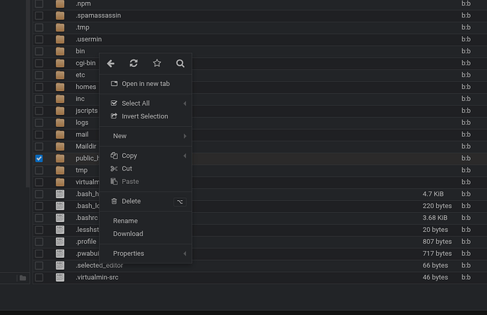

right click using the Webmin/Virtualmin file manager does not give that option if you right click on a directory
look for yourself but I don’t see it, unless I’m looking in the wrong place perhaps
Sure, when you select download it will tar.gz
I believe that is what @shoulders was stating but only he can explain
what put me on to this is
to me that sounds like a Windows term and not a Webmin/Virtualmin term, in the Virtualmin enviroment you would use ‘file manager’ to give the OP the correct function to use.
file manager does not give you the option to download as a zip file

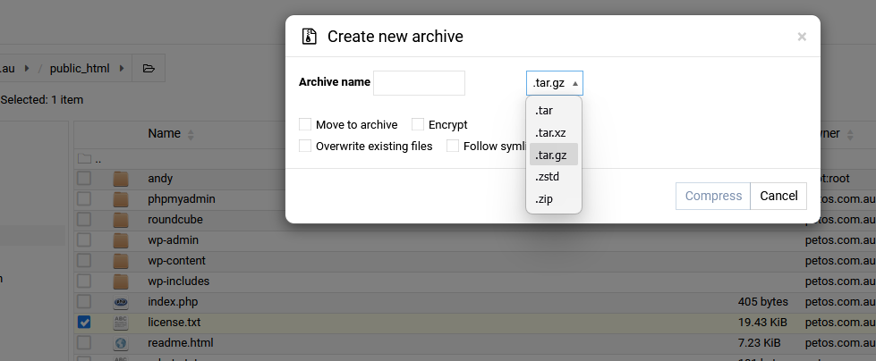

can you tell me how to download as a zip rather than a tar as it would be easier to pass these files onto the customer in zip format rather than tar.gz
Understandable, I guess we all mix terms when using many tools daily.
I would also like to know if there is a way to .zip instead of the default .tar.gz as most end users understand .zip much more

Filemanger has zip
@stefan1959
Thanks for the info

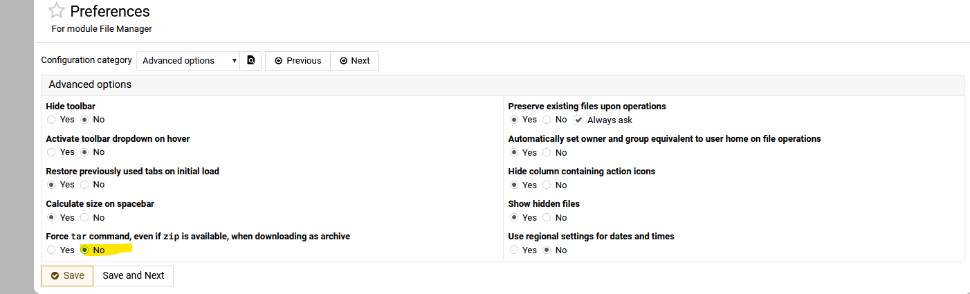

Also set this in filemanger preferences, mine was set to yes.
@stefan1959
Perfect thank you :+1:
