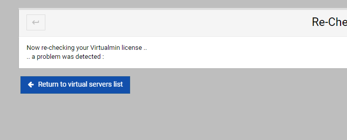

Our recheck license procedure has started failing all of a sudden with no error:
Now re-checking your Virtualmin license ..
.. a problem was detected :
I have checked a few older threads with a similar issue but none of them seem to have the same root cause as ours. Firewall is clear of blocked ips… we can reach the url for validation, and I don’t see anything useful at all in any of the logs…
Where else could I look in order to start debugging this?

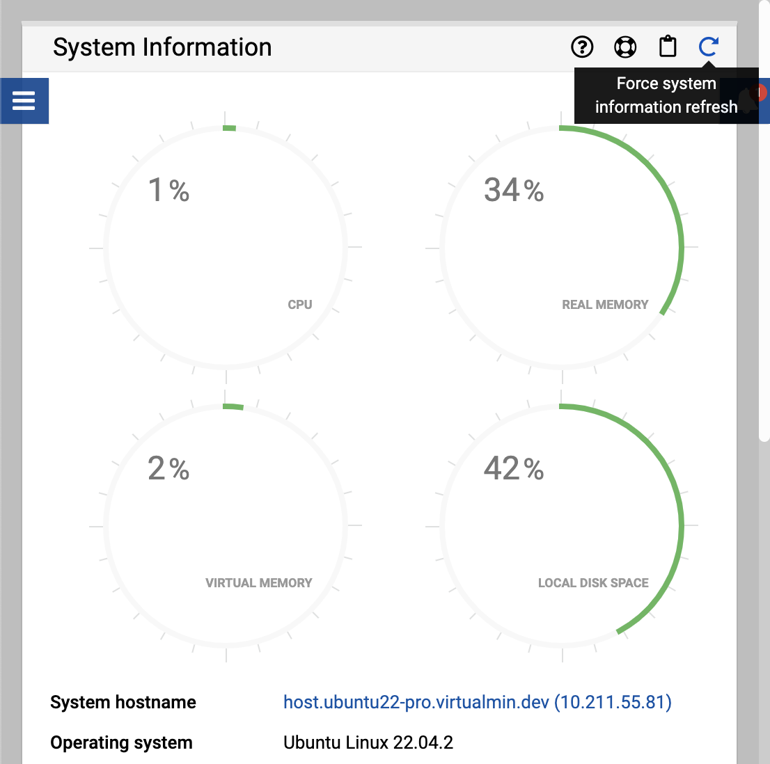

If you go to the dashboard and click refresh button at the top right of the dashboard, and then try to re-check your license – does it work then?
This button, e.g.:
Hi @Ilia - It still gives the same problem unfortunatley
