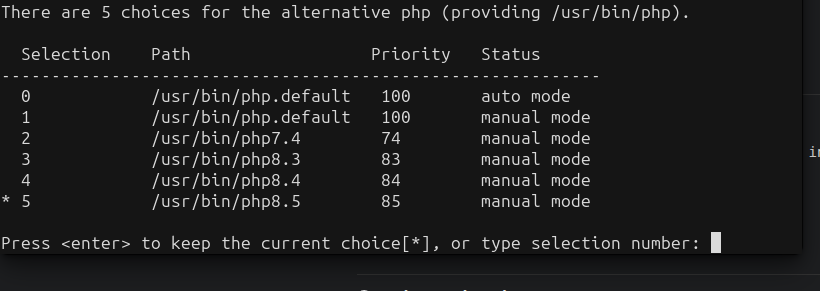

for which user root or a domain owner user ? and which user does FreeScout run as ? if you followed FreeScout’s installation instructions to the letter Freescout would be running as the user www-data. Please supply more information on how Freescout was installed as I guess everyone is guessing as to what went wrong without the facts from yourself.
however as you use Ubuntu 24.04 you could run this command from a ssh login
sudo update-alternatives --config php
and from the options choose the version you want the default to be.

Thanks for the screen and the command to choose the default PHP for client, I have already wrote that after 24 hours of issues I found that as solution.

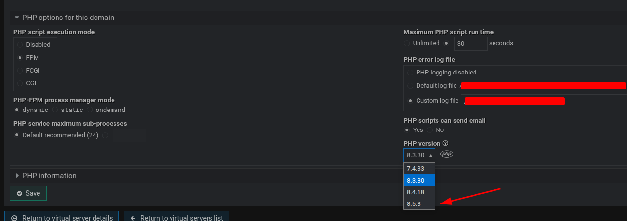

If I had PHP 8.4 why the Web App broke PHP by set PHP 8.5 as default PHP client?
This PHP 8.5 is not selectable by the Virtualmin interface so I suppose some issue has happened on the web app Wordpress setup process.
I seem to be able to select PHP 8.5 from the virtualmin interface just fine
