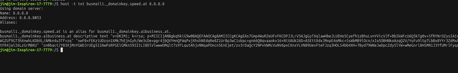

when I just tried your name servers I get
as you can see the name servers (at this moment) are still timing out,
but if I do this it works
looks as though your name servers are unreliable, as suggested before switch to another name server to get reliability

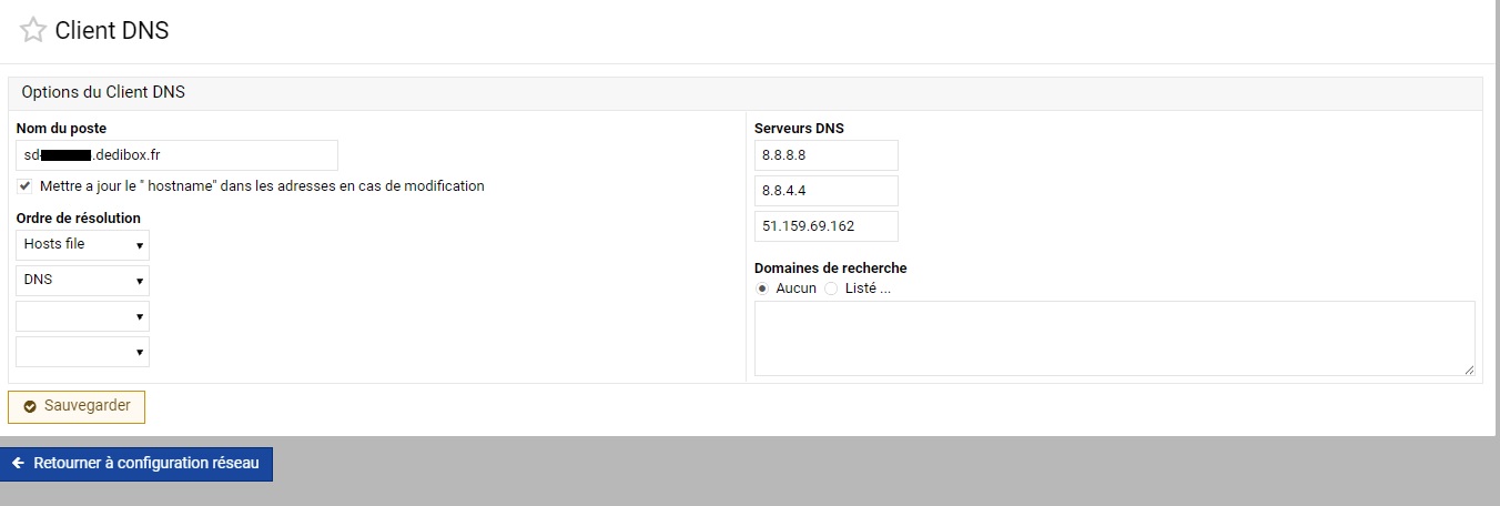

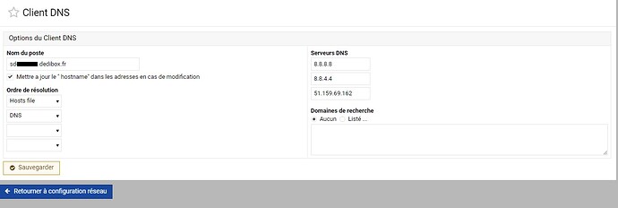

And yet, my server is indeed hosted by Scaleway. How do I change the DNS server in Virtualmin?
In Webmin => Networking => Network configuration
Change the value in DNS servers to another, for exemple 8.8.8.8 for Google or 1.1.1.1 for Cloudflare
I just changed the settings like this.
The problem persists; emails are still not reaching Outlook, Gmail, etc., forwarding addresses.

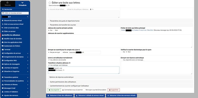

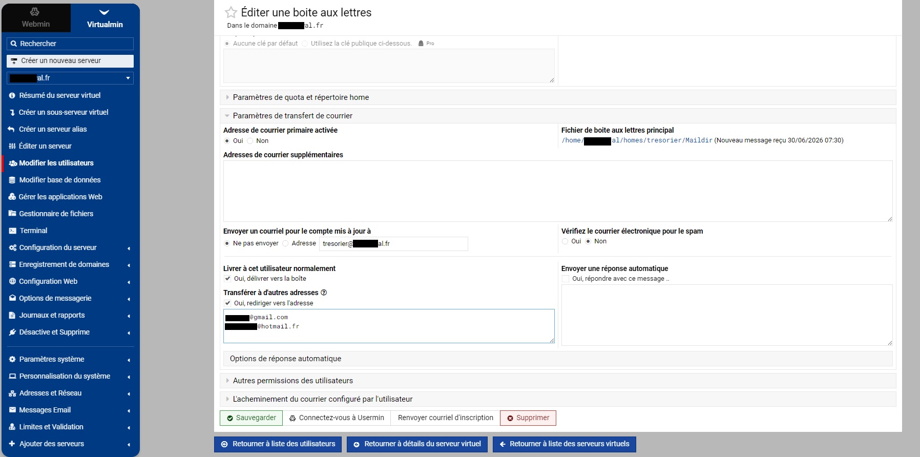

I created an email account (tresorier@xxxx.fr) for one of these domains. When I check this account, I receive all the emails correctly. The account is also configured to forward incoming emails to a Gmail address and a Hotmail address.
The problem is that some emails aren’t being forwarded, even though they do arrive in the “tresorier@xxxx.fr” inbox.
I am part of a group where several people cannot access the “tresorier@xxxx.fr” inbox directly. The goal of the setup was to forward incoming emails straight to their personal email addresses, but they aren’t receiving all of them.

I realized that the email address “tresorier@xxxxx.fr” was forwarding emails to an address “userxxxx@xxxxx.fr,” which was itself forwarding to a Gmail or Outlook address.
I also tried forwarding directly to an Outlook address as a test.
