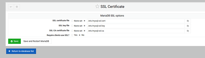

to mariadb, certs installed fine. restart fine.
from the webmin interface ?? if so what happens when you update the cert used ? where does webmin place the cert ?
yep, from the ssl in the Virtualmin, hmmm ok different location.
after setting the cert I see
I’m running Rocky9, I see the ssl files in etc
ok it’s Ubuntu causing the issue then as both myself and the op are running Ubuntu
