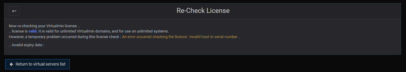

Oh, wait, nevermind, I do see code for it: https://github.com/virtualmin/virtualmin-gpl/blob/f72c28dfdbd8927d8e2330101a49add11a22bf57/virtual-server-lib.pl#L260
I have no idea what’s happening.
Yep. That explains everything. So, I guess the problem is downgrading to GPL didn’t actually work. I don’t know why that would happen.

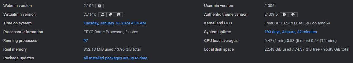

And a snippet of the relevant portion of my Dashboard.
Delete the /usr/local/etc/webmin/virtual-server/pro
directory and everything in it if it exists, and then use the Webmin Configuration->Webmin Modules page to install the latest wbm
version of the virtual-server module from https://software.virtualmin.com/vm/6/gpl/wbm/virtual-server-7.9.0.gpl-1.wbm.gz
The downgrade probably isn’t dealing correctly with a wbm installation.
You may also find everything is easier using a well-supported Linux distro. It just gets so much more testing (hundreds, maybe thousands, of times more users), it’s much more likely to Just Work.
Success! /usr/local/etc/webmin/virtual-server/pro
didn’t exist. I went through the manual upgrade process you suggested and the Dashboard is reporting 7.9.0, and I see the green nag box to try pro again. Lesson learned the first time, I’ll ignore that box now.
