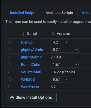

Did it update install scripts to the latest?
Also, the latest Virtualmin version is 7.9.0.
Just checked, nothing updated that I can tell.
Still running 7.7. So, it appears the script isn’t downloading. This brings me back to my firewall. Is the update script running on an odd port? Is there a verbose switch for the script (so I can at least see where it’s failing)?

@Ilia @Jamie shouldn’t that be going to http://latest-scripts.virtualmin.com/gpl/scripts.txt
I don’t see code to handle that in https://github.com/virtualmin/virtualmin-gpl/blob/master/virtual-server-lib.pl
I thought we’d discussed this a while back. Surely this hasn’t not worked for all that time?
While this may still be unrelated. I noticed that even after downgrading my install back to GPL, The Webmin/Virtualmin sysinfo is reporting that I am still using 7.7 PRO. Could the scripts inability to poll updates be related to this?
