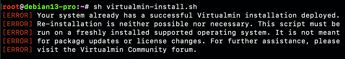

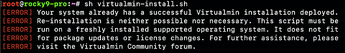

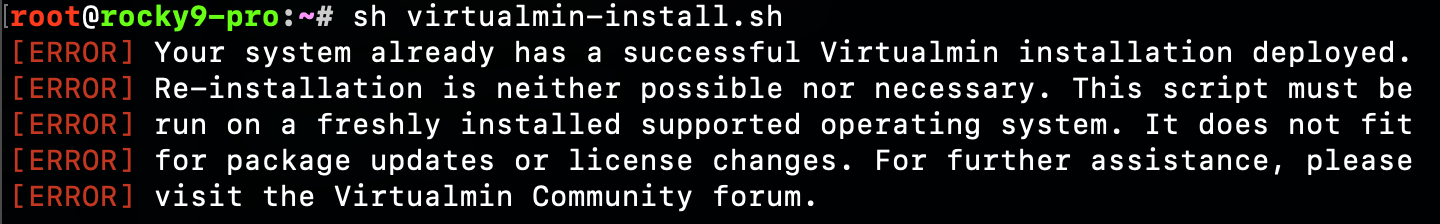

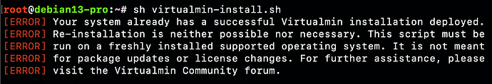

“It does not fit” is weird language, “It is not fit” would be better, but it sounds like it’s saying the installer is broken for doing those things…it’s not a bug that it doesn’t do those things, it’s literally not supposed to do those things.
Better to say, “It is not for updating Virtualmin or making license changes.”
How does it know the installation was successful? (I mean, we can know there has been an installation through a variety of tests, but successful is a pretty high bar. Though I guess if it wasn’t successful running it again is probably not going to do anything good without understanding what broke, in which case, they probably can just run the right virtualmin config-system command(s) to complete the install.)
Thank you, you’re right. It sounded awkward. I have fixed it, though, with slightly different wording, as I want all the letters to fit the width equally.
It’s very simple. If the installation is done using the new installer and completes without errors, we create a file in /etc/webmin/virtual-server/installed-auto and later test against it. No complicated tests.
