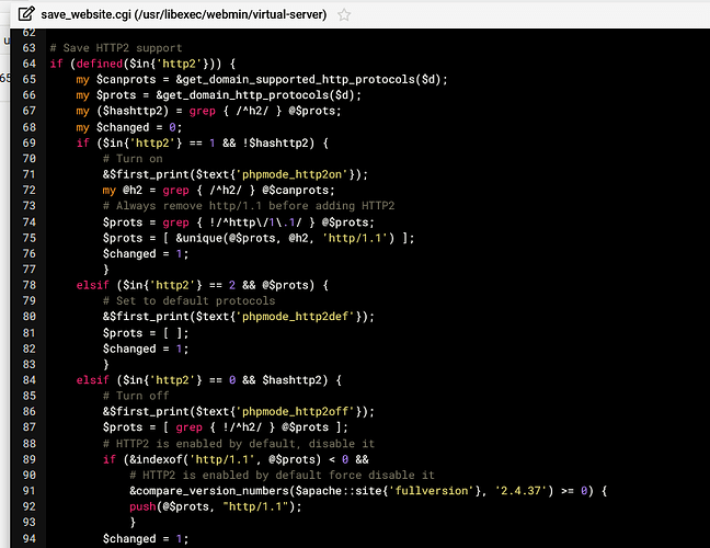

This patch should fix it:
I added fix, one small issue still if I go from Default(Yes) to No it fails
But if I go from Default(Yes) to Yes and save then to No and save it works.
And the toggling Between Yes and No works (not use the Default(yes).
I’m pretty sure I changed the code ok, and I can see the push(@$prots, “http/1.1”); should fix the no.
I reverted that patch, and checked in this simpler one that fixes it : Fix turning off of HTTP 2 · virtualmin/virtualmin-gpl@1fb7f8a · GitHub

@Jamie, unfortunately this patch is not entirely correct. If we have HTTP2 explicitly disabled first, i.e.:
Protocols http/1.1
… and then a user wants to enable HTTP2, the Apache will end up with incorrect order of directives, i.e.:
Protocols http/1.1 h2 h2c
This is the reason for that additional line of code. Check these two fixes:
Nope, if you properly applied my initial patch, you shouldn’t see mentioned behaviour.
What effect does the order of directives have? If we need to be able to control this, the UI will need to be more complex…
The first protocol will be tried, i.e. http/1.1 and HTTP2 will never work?
I think I have also fixed that on the template side in another commit (linked above).
What I meant was, will we ever need the UI to control if h2 comes before http/1.1 , or the other way around?
No, as UI should have just basic options, like ● Default, ○ Yes, ○ No. We do the logic, making sure that http/1.1 always placed after h2. It’s explained and described in Apache docs that protocol order matters:
https://httpd.apache.org/docs/2.4/howto/http2.html#basic-config
Ok, if we know that http/1.1 should always come last, that’s fine.
