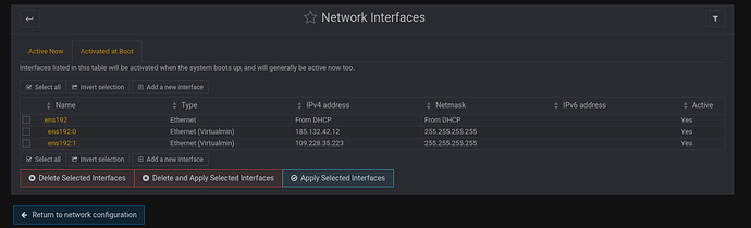

the problem is it’s not changing at all, tell me how you get that the IP is changing. All I did was add a virtual interface with the extra IP as my vpn supplier has the default IPas one starting 185 & the 109 one was added afterwards … I think more the problem here is VM didn’t write the netplan config file correctly reading the above posts shows how I fixed it and how it was after the new virtual interface was added via virtualmin
Based on the screenshot, it appears you “changed” your NIC’s primary IP address from “185” to “109” which changed the “default IP” address. Then you “added” the “185” address back as a “virtual adapter”.
Is there a reason you didn’t simply “add” the “109” address as the virtual adapter?
Just trying to make better sense of how you actually got to where you are now.

I did, I didn’t mess with anything else & this was the result
Just So everyone is clear this is the process I followed
- reimage the vps with Ubuntu 22.04
- using install.sh installed virtualmin/webmin
- created some domains
4 changed one of the domain’s IP to a new one using
The result from this was
then after a reboot it altered to this
after reboot the netplan config file looked like this
This was the config for netplan with the nag screen.
To remove the nag screen the netplan config had to altered to
as you can see virtualmin forgot to add the 185 ip address to the netplan config, after adding the 109 address, as per above, and rebooting the vps everything returned to normal.
As I foot note up until now I have not researched network interfaces until now ( to try and fix this problem) in the past virtualmin has never failed but to be fair Ubuntu <= 20.04 you didn’t have to use net plan but it appears in 22.04 it’s the default. in fact in the past Jamie told me to remove the directory “/etc/netplan” as the boot up interfaces don’t show in the webmin module with this directory present therefore I am new to netplan

Peter, IP address shouldn’t be changing, if this is a dedicated [virtual] machine in a datacenter.
You shouldn’t use DHCP. Use static configuration. For example:

Static configuration can also be setup using Webmin / Networking ⇾ Network Configuration: Network Interfaces page:

I think it’s easier to just remove dhcp4: true line from your netplan config file and run netplan try to see if that works.

That failed in a big way … running netplan try just locked me out of the machine … back to a reimage I guess
ok after a reimage I now end up with this after a reboot

on reimage the netplan original config was
network:
ethernets:
ens192:
dhcp4: true
accept-ra: true
version: 2
after I added the extra IP it was
network:
ethernets:
ens192:
dhcp4: true
addresses: ['109.228.35.223/32']
accept-ra: true
version: 2
to get it to work It was altered to
network:
ethernets:
ens192:
dhcp4: true
addresses: ['185.132.42.12/32','109.228.35.223/32']
accept-ra: true
version: 2
I wasted a whole afternoon turning DHCP off ![]()
I don’t see DHCP4 being disabled, as config option named dhcp4: true still present on your netplan config file. You may also want to setup routes and nameservers in static IP configuration.
It can be done in Webmin using Networking ⇾ Network Configuration: Routing and Gateways and Networking ⇾ Network Configuration: Hostname and DNS Client pages.

Also, I would suggest to contact your ISP to help you to switch to static network configuration.
If you wish to do it on your own consider using ip route and resolvectl status commands to fill the right network configuration.
Additionally refer to this netplan manual:
I’m just going to leave it as it is as it’s working
ip routeandresolvectl statuscommands to fill the right network configuration.
went back to ubuntu 20.04 … as vm seams to have issues with 22.04 … this did fix the above problems but that said after reboot the virtual interface disappears rather than adding loads of interfaces with the same ip
