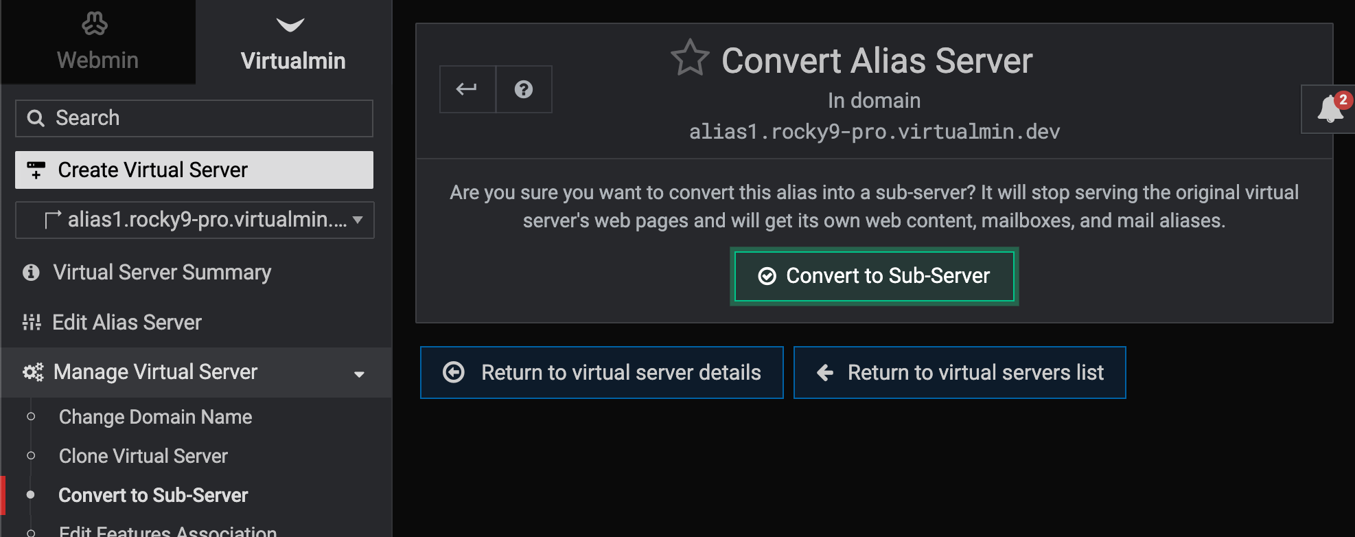

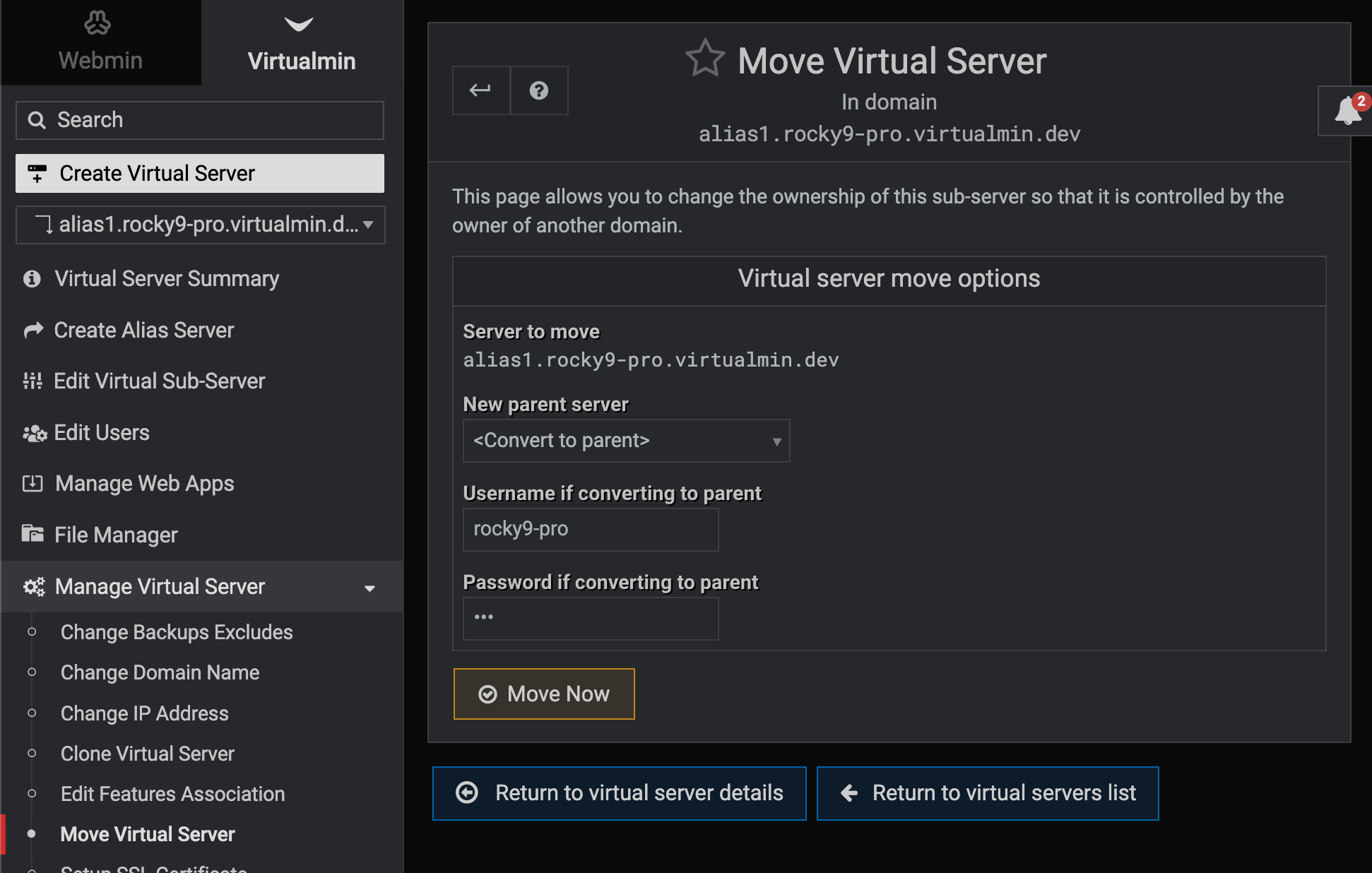

You can use the Virtualmin feature “Manage Virtual Server ⇾ Convert to Sub-Server” to convert an alias to a sub-server and later “Manage Virtual Server ⇾ Move Virtual Server” feature to convert the sub-server to a top-level virtual server:

Oh, I didn’t even think of that path.
Oh, but, wait. That’s going to be its own content, not the parent that OP wants to rename to the Alias. So, that isn’t a solution.
I’m not sure I understand what that means, since I thought the OP wanted to “promote” the alias to a top-level domain.
Yet, re-reading the questions and thinking more about it, if the goal is to make alias1.domain.tld into domain.tld while keeping all the settings and content of domain.tld, then the easiest way is to delete the alias and rename the origin domain to the name alias used.
