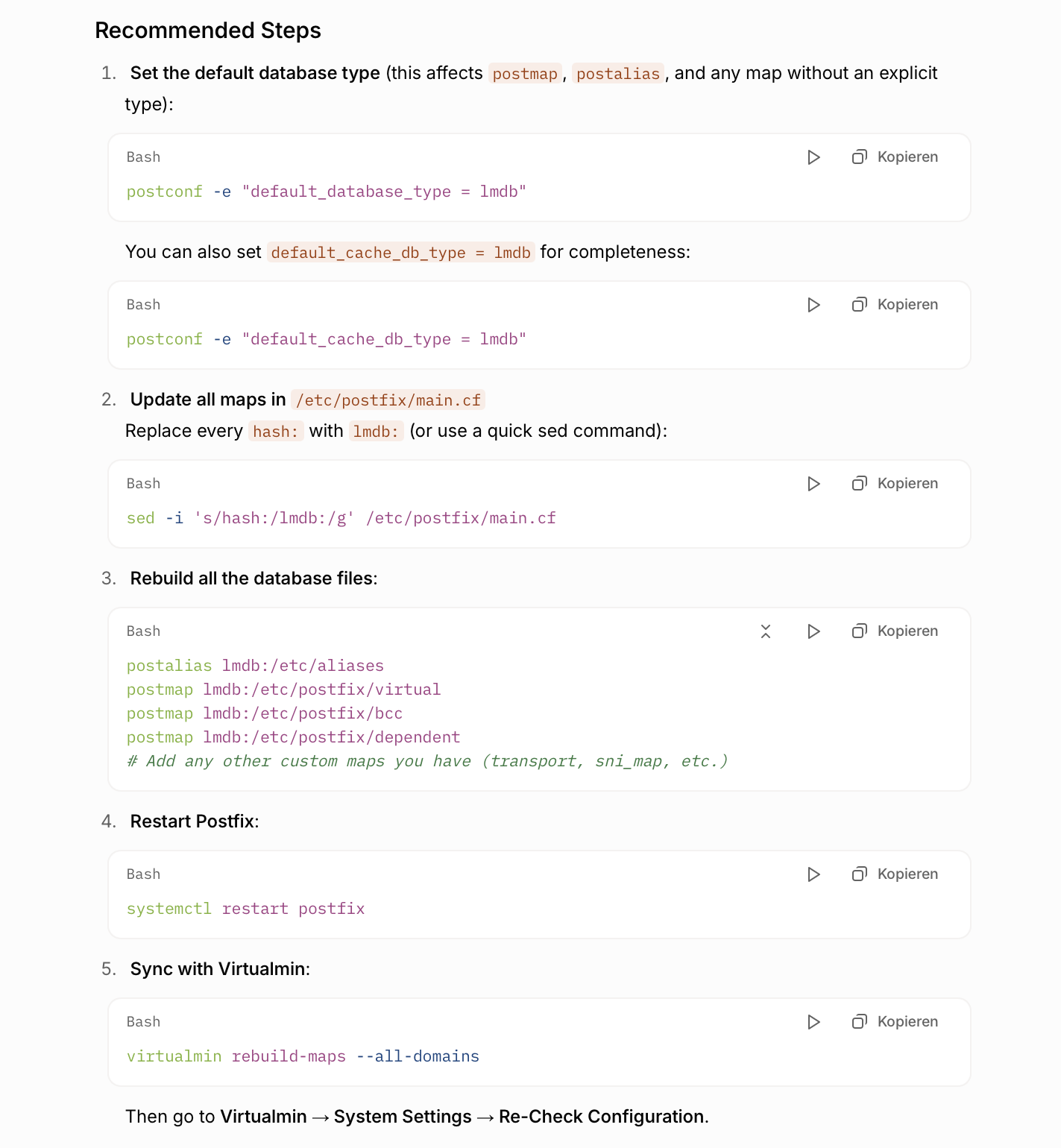

I want to switch to lmdb in postfix as Berkeley DB is being deprecated.
I know Virtualmin can handle lmdb by default on alma 10 and derivatives but I was wondering if it can do it on my alma 9.7 install.

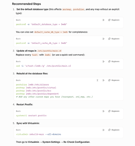

Ai suggest the following:

Virtualmin/Webmin doesn’t care. It uses the tools provided by Postfix for interacting with the databases (e.g. postmap). Virtualmin does not interact directly with the db files in any circumstance.
They have docs on it
I migrated using a script like this, worked great:
