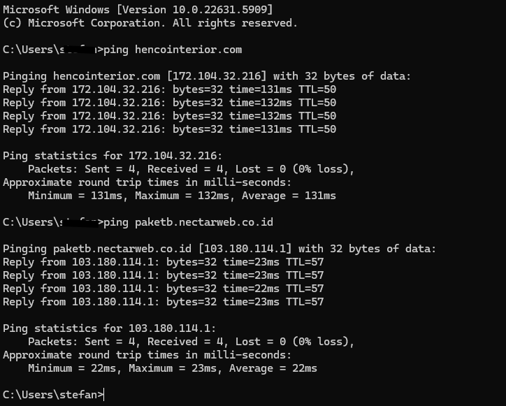

I ping those domains and they using different IP’s, I thought they should be the same.
paketb.nectarweb.co.id is using bunny DNS proxy DNS. What shown in your ping is bunny DNS IP.
hencointerior.com is using direct DNS zone from domain vendor.
They are at the same server actually.
