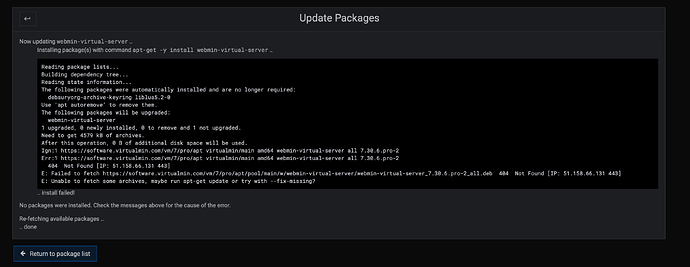

[SOLVED] Updating to 7.30.6.pro-2 fails with 404 not found
OS type and version Debian GNU/Linux 11
Webmin version 2.302
Virtualmin version 7.30.4 Pro
Webserver version IRRELEVANT
The file # /etc/apt/sources.list.d/virtualmin.list contains:
deb [signed-by=/usr/share/keyrings/debian-virtualmin-7.gpg] https://software.virtualmin.com/vm/7/pro/apt virtualmin main
apt update returns:
OK:4 https://software.virtualmin.com/vm/7/pro/apt virtualmin InRelease
apt upgrade returns:
Ign:1 https://software.virtualmin.com/vm/7/pro/apt virtualmin/main amd64 webmin-virtual-server all 7.30.6.pro-2
Fehl:1 https://software.virtualmin.com/vm/7/pro/apt virtualmin/main amd64 webmin-virtual-server all 7.30.6.pro-2
  404  Not Found [IP: 51.158.66.131 443]
E: Fehlschlag beim Holen von https://software.virtualmin.com/vm/7/pro/apt/pool/main/w/webmin-virtual-server/webmin-virtual-server_7.30.6.pro-2_all.deb 404  Not Found [IP: 51.158.66.131 443]
Until today, all updates worked fine. Anything wrong in the current release or am I doing something wrong?
Thanks @Ilia for the very fast response and the good work!
Case closed :wink:

Relax. 7.30.7 will be in the repos in a few minutes.
