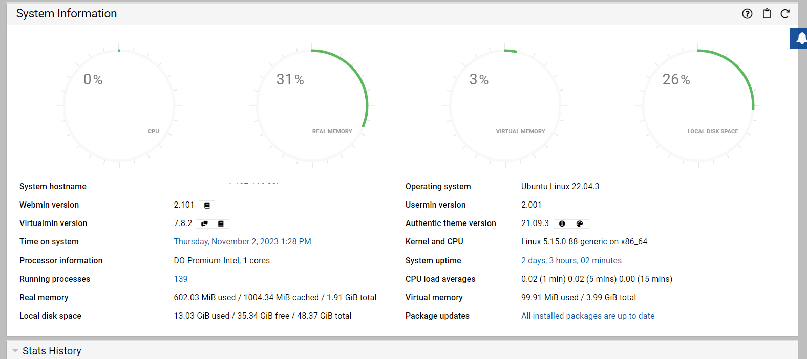

That is very strange! Does your Dashboard look like this? (NB I have whiteout
the host name and IP - your memory etc would be different.

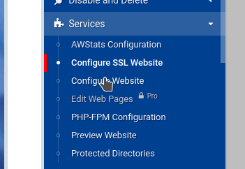

As for the Services sub menu this is what I have: (NB this is a Nginx webserver installation so no Apache)

@ID10T Do you have a Services sub menu different to me?
Maybe this module isn’t available for nginx?
mine is different again
it really depends on how you configure virtualmin as to what shows up
Thanks. Any idea of what “configuration” triggers that? Is it just the fact I am using Nginx?
I’m using a different theme, so I don’t see what you see.
Info on WM and VW isn’t displayed below the Stats graphs.
This is what I get in Services:
Screenshot 2023-11-02 at 14.37.12
Apache server here.

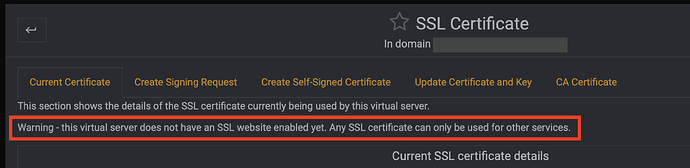

Perhaps this in Server Configuration > SSL Certificate is relevant:
That seems wrong, however, as the site does have an SSL website enabled…
