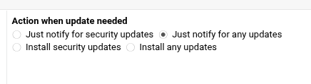

Security updates are being install automatically
I never set anything as per instructions when setting up Virtualmin, nor have I enabled this by the CLI myself. :smiley: . This was done by the OS. I also used the Ubunutu Minimal Server install.
The question becomes WHERE to draw the line. It would be easier if only a single distro was supported, BUT, if you are going to support multiple distros then the behavior needs to be the same across all. If one distro automatically installs a feature that isn’t on others things start to get chaotic. If the interface shows one thing and the underlying distro is doing something else, well, that is a problem. They need to be synced. The panel must accurately reflect what is going on if a setting is offered.

I think we’re still getting our wires crossed here a bit. There are two separate layers in play, and they’re not the same thing.
The setting in *min controls what *min itself does when it checks for updates. It doesn’t, and frankly can’t, magically overrule every other update mechanism you may have running on the box. Joe has already said as much: if unattended-upgrades is installed and active, then those updates are being handled by the OS, not by the control panel. That isn’t Virtualmin “ignoring” its own setting; that’s a separate bit of software doing exactly what it says on the tin.
And at this stage, that’s not even up for debate, because your own systemctl status unattended-upgrades output shows the service is enabled and running. So there is already a perfectly ordinary explanation for what you’re seeing. No mystery, no conspiracy, no panel gone rogue in the night.
Now, to be fair, I’ll grant one point: the wording in the UI could perhaps be a touch clearer for people who aren’t living and breathing Linux package management. If the argument is “the interface could make it more obvious that this only applies to updates managed by this module, and not OS-level automatic update services”, that seems entirely reasonable to me. Fair enough. That’s a feature request.
But that’s quite a different kettle of fish from saying, “I selected notify only in Virtualmin, therefore nothing on the OS should install updates automatically.” That simply doesn’t follow.
A control panel is an admin layer. It isn’t a replacement for the operating system, and it isn’t the Supreme Court of apt. Once unattended-upgrades is installed and active, you have explicitly allowed package operations to happen outside the panel. Expecting Virtualmin to somehow veto that is a bit like blaming the dashboard because the engine started when you turned the key.
What makes this all slightly more awkward is that your own notes on update policy explicitly mention unattended-upgrades on Debian/Ubuntu, and also acknowledge that some update behaviour is not controlled by Virtualmin or Webmin – under " Update Strategy (Policy)". Which is, with respect, more or less the very distinction being explained to you here.

it is on, but I did not install it.
If an option is offered then it should be honored. I’m still on Debian 11, upgraded from 10, and I don’t see this behavior. This may be a more recent ‘do gooder’ feature that has been added and Webmin will need to take it into account now or stop offering the option if it can’t honor it.
The panel simply MUST be in sync to what is happening. That kinda is the purpose of the panel.

We can add a notice about it, but this is one of those OS things we don’t want to change without being clear about what’s going on. We certainly wouldn’t want to disable it as part of our installation. We really try to respect your choices, and if you’ve installed a package that performs upgrades automatically, we don’t want to break that (we have no way of knowing whether you or your host installed the package, we know we didn’t install it).
It’s a ubuntu thing i guess, it’s been around on ubuntu for a while now and i would guess it’s a service that is installed and enabled when the OS is installed so therefore the virtualmin installer wouldn’t touch it on installation but that said perhaps if the virtualmin installer detects it, it could disable the service and warn the user it has been disabled and an option to enable it or just report to the user it’s installed and enabled and give them an option to stop and disable it if they so wish
Management software must reflect the state of the machine. It the service is active then it should be reflected here. Most will probably never see this page anyhow.
Then if the user clicks it off, then disable it. This should be no different than anything else being managed.
No! If a control panel would do that (or similar actions), it’ll be heading the wrong direction and I would clearly challenge the dev team upon their decision-making.
The UI for this particular thing is not managing unattended-upgrades. It’s managing a Virtualmin feature, which does not use unattended-upgrades to perform updates. There are often multiple ways to do things, and e.g. the Firewalld module should not change the state of a Shorewall firewall or vice versa.
And, that package is not available on all of our supported operating systems, it is a Debian package that also appears on Ubuntu.
Again, I can see how this could be confusing for folks unfamiliar with unattended-upgrades. So, we can certainly make it provide a notice if unattended-upgrades is enabled to alleviate that confusion. But, unless we make a module/page for the unattended-upgrades package/service, clearly labeled as such, it feels disrespectful to modify that state without being clear about what is being modified.
Since unattended-upgrades is not available on EL systems (it has dnf-automatic, which is new-ish, there have been previous ways of doing it), it doesn’t make sense to make it the default way to manage this capability. If we did make it manage an OS-package we’d then need to depend on it, configure it at install time in some sensible way (we have no easy way of knowing what you did vs. what your host did in terms of installing/configuring it). And, it’d have to be clear that it’s managing some OS service. I dunno. Jamie likes to make features like this generic and not dependent on a specific OS/version.
