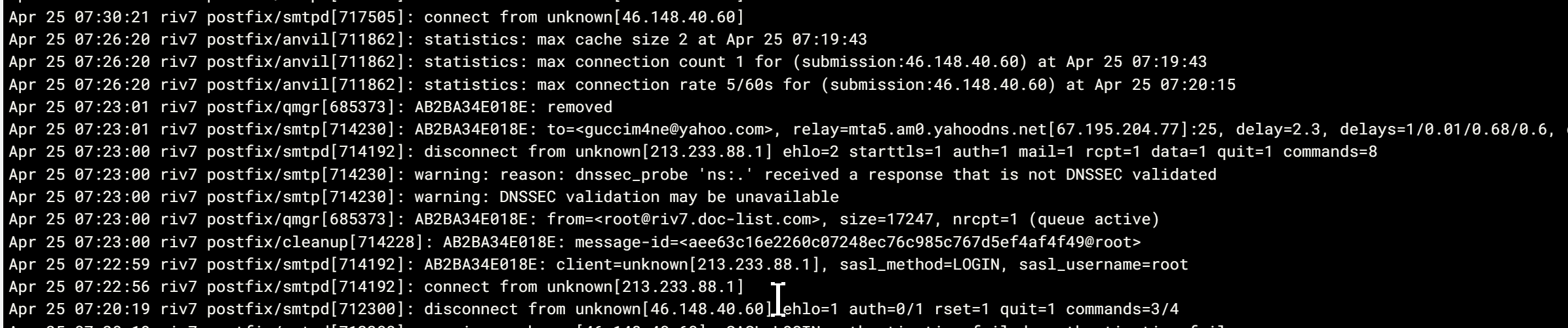

I am having a problem with unauthorized users using my system as an email relay. One IP address in particular is constantly trying to access my smtp interface. I have added the files Sender_access and Client_access to block this person, it looks like successfully, but it is annoying to have this person try to connect to my server every second. It also makes my logs very large and hard to examine.
However, it looks like occasionally a hacker has gotten in. They then created thousands of emails which is damaging my ip reputation and of course generating tons of spam. I have been monitoring this situation as I have added more rules to postfix and usually can erase the queue before too many messages are sent. I have noticed the few times this has happened it looks like someone is logging in using root.
