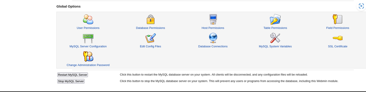

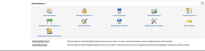

update: i ve added two views - of the SQL-Execution options… seee below the … view on the general SQL-Execution widget -( which is not installed (or activated) on my site here:

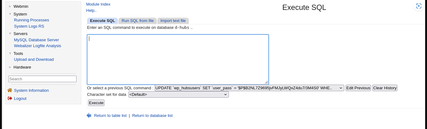

see the per-db-execution-widget - i have this option .. and i guess that i can run all the commands i need to run for db creations and so on.. here!?
can you confirm that!? can you confirm that here everything is possible - in SQL-creation… ?
look forward to hear from you

update2 and some more findings: found out some more inights
tip for (WordPress) admins running Webmin without CLI access:
we don’t need to rely on Webmin’s sometimes buggy GUI (refreshing very very often does not work its a pain in the ss ), to create databases and users: The per-database SQL execution widget (see the image above) can run any SQL statement, even global ones.
thats just awesome! :smiley: :star_struck:
That means we can: (/run all (!!) the SQL-commands in the per-database SQL execution widget
create databases (CREATE DATABASE ...),
create users (CREATE USER ...),
assign privileges (GRANT ... ON db.* TO user@host;),
…and verify everything with SHOW DATABASES; and SHOW GRANTS;.
This way, every WordPress site gets its own DB and user, which is much more secure than re-using accounts. Once weve learned the basic sequence, we’re independent of the GUI and fully in control.

I don’t know exactly what this means, but if Webmin fails to create a database or user, I would suspect an OOM killer event, rather than a bug. But, if you have a lot of memory and the problem is reproducible, we’d like to know about it, with details of how to reproduce the problem. We fix bugs when we know about them.
I think most folks will be creating a new domain per application (I would be and it’s what I recommend for root-level users, which you would have to be, to do what you’re suggesting), which gives you one database and user per application in Virtualmin.
This won’t be true for domain owner users, who don’t have the necessary privileges to create a new parent domain, though…that’s kind of a quirk that falls out of the user/ownership model in Virtualmin. At some point we’ll probably separate user from domain, completely, but how that implementation would work is complicated.
Virtualmin Pro also has some more advanced database management features in the GUI, which I believe also allows new databases and user/passwords independent of the domain.
But, yes, you can certainly manage databases directly, as well, if you really want to.

i now verified that i can run lots of SQL-Statements in the “per-DB-SQL-Editor” and thats very fine,
regarding the refreshing-thing. I noiticed years ago that some manually created dbs were nt visible in the overview - but if you run a correspondand SQL statement then you see it in the list..
I noticed this years berfore - and verified it last week - while doing some tests. in other wordsL: With SQL-commands you see a whole lot more.
