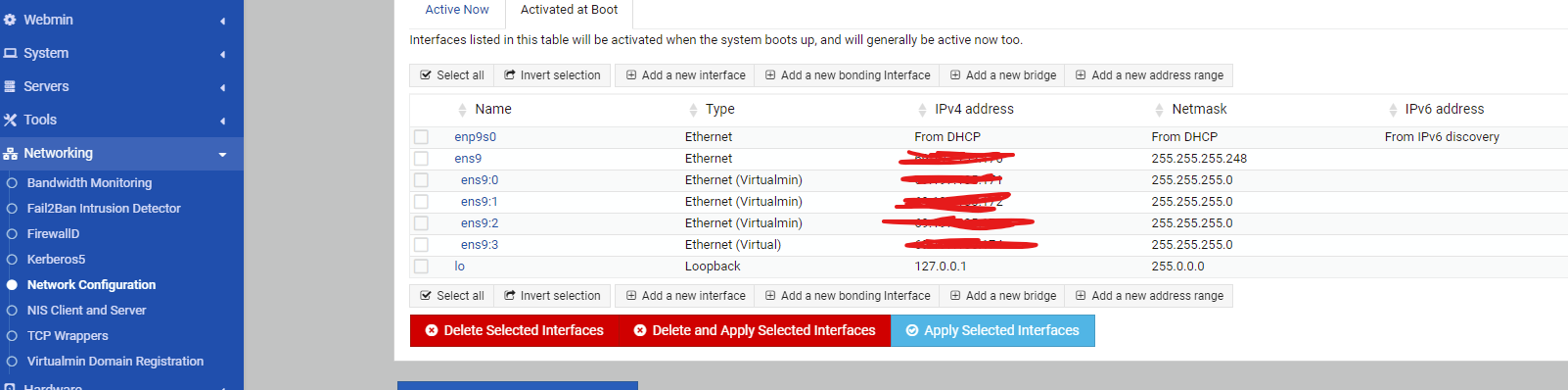

The server has five consecutive independent IP addresses. The screenshot is the server’s network card configuration information.
On the old version of virtualmin/webmin server, the same network card configuration, the same system, the Restore-domain.pl function can work normally.
