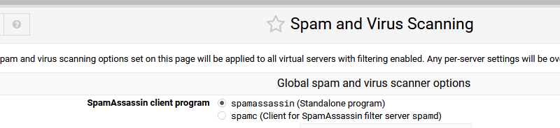

I know Virtualmin allow to delete virus email and even spam email above custom score, this is good but can be better.
For example… In those days I discover a lot of spam arrive in my inbox… so I reduced the score from 5.0 to 3.0 and this worked… a lot of spam now goes on the spam folder.
In Plesk I was set some rules to refuse certain spam email so I thought about refuse spam email above 3.0 score on Virtualmin but I was not able to do. Why refuse, reject instead of silently delete? To avoid false positive disaster.

Are we on about the same thing?
Obviously not.
SpamAssassin is not ClamAV. SpamAssassin checks for spam. ClamAV checks for viruses.
