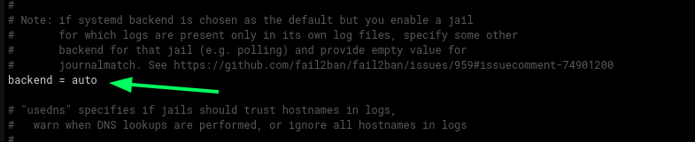

By simply comparing jails that work on a non-Virtualmin server, I found that adding these 2 lines to the jail got it working.
logpath = /var/log/virtualmin/*access_log
backend = auto
Delete the exiting logpath line first.

where did you add the backend = auto in the jail file ?
OK BINGO … this one worked for me. its now banning xmlrpc.php requests.
I want to say thankyou to all here very much appreciated.
And thanks Randomz for the final piece of the puzzle.
So question, what exactly does backend = auto do ???
Michael
did you not read post 44 ?
yes I did, but found it a little vague. I was about to go and read that github link for a better understanding.
Under Virtualmin the backend is set to systemd, yet on a system without Virtualmin - but still managed by Webmin it is set to “auto”.
