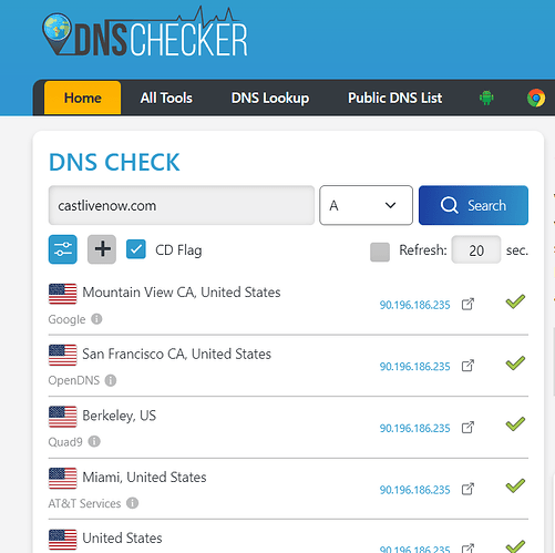

i can use mxtoolbox to check
this is what coming up
Note: A record has different IP (older?)
Which probably explains the connection problem

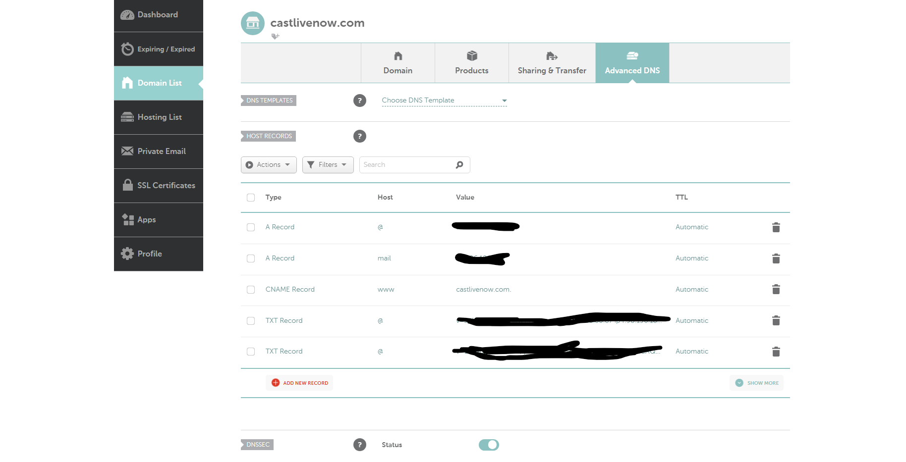

this is what i have on my namecheap dns settings as im using there dns servers and have my domain with them to

If you look at that image I posted above from DNSChecker
Screenshot 2023-07-11 142523
if you click on that it normally takes you to a Google map of the location of the IP4
This would typically be the location of the physical box (or more precisely the box’s connector to the internet) In my cases the physical location used by my client’s registrar or the box provider (Digital Ocean, Ionos, Linode, ExpressVPN).
In your case it shows your home address, along with a google’s (invasive) earth picture of your house.
That not always the case, my IP come up as brisbane, about 2 thousand klms away.
