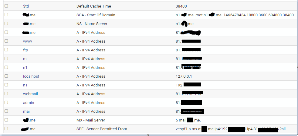

Hi and thanks for fast answer.
https://i.gyazo.com/d2419e9bda995d92686aaf807d55feb4.png
here are the dns records for the main virtual server

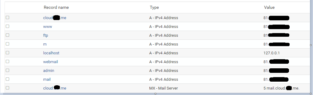

https://i.gyazo.com/90aeaed95608e86c83cd9ce7763afc96.png and here from the subserver
when i dig the main server showes the ip address for A record, but when i try the same for the subserver doesnt show the ip address

Created automatically i just added the n1 A recird for the name servers.
All pointing to my externan ip and then to my virtualmin server local ip
Now i managed with dig to show corrent information but still the site not loading. when i try it says DNS address for the site couldnot be found
