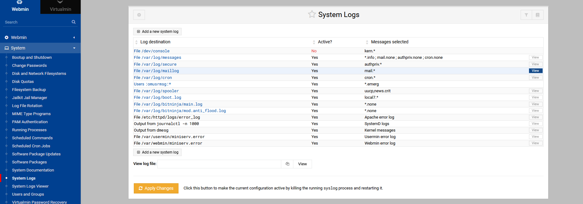

webmin should show you where the logs are
there is no System Logs on webmin on Debian i just checked two systems. Neither mail.log

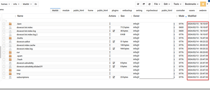

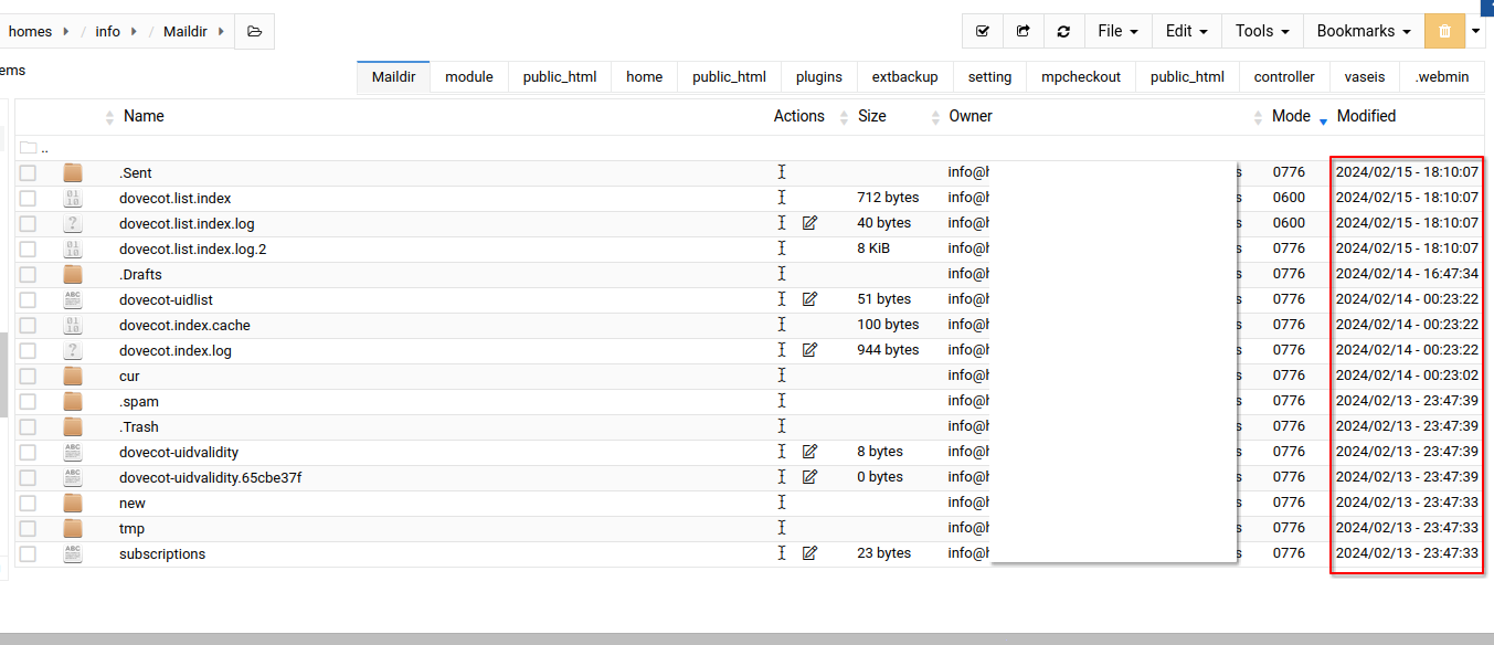

And Virtualmin still shows that emails are received on this user
εικόνα
but the folder has no mails received

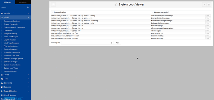

Yes, but nothing usefull exists there:
I had already also checked the whole journal log, not only about postfix, when sending an external email. There was no log regarding the email’s i was senting to the user
I see log files in webmin, not sure what you mean about module.

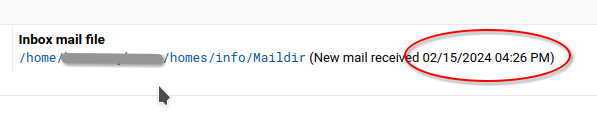

Please explain me this behavior, so i can check what’s happening. What is this page’s code in virtualmin reads to show the time of last mail?
εικόνα
I Checked the code and saw that the “New mail received” variable $lastmod is just checking for changes in Maildir folder for changes, and it seems to be changed every time you press refresh on roundcube to check for new mails. So it’s irrelevant actually with mail receiving.
