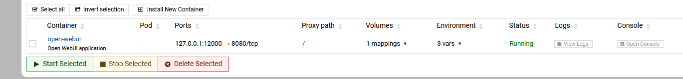

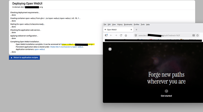

Installed fine for me on Rocky 9.
Port mapping is different
