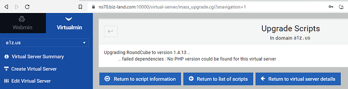

No php version could be found
OS type and version Rocky Linux ns70.biz-land.com 5.14.0-284.11.1.el9_2.x86_64
Webmin version REQUIRED
Virtualmin version REQUIRED
PHP 8.1.14
Upgrading WordPress to version 6.2.2 …
… failed dependencies : No PHP version could be found for this virtual server

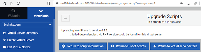

Same error in another machine:
Linux ns60.biz-land.com 5.15.0-75-generic #82-Ubuntu
so you have this
Yes, but, my PHP version is 8.1.14 (Rocky Linux 9)
so the worpress is already installed, can you update ok from the wp admin?
Also Re-check Configuration, it may fix. You using fpm?
getting a db con error after logging in. will fix that and get back to u asap
Fixed DB connection problem (and some additional problems with the install).
Was able to update from WP Admin.
So, it is fixed on one machine (RL). One more to go.
You can set autoupdate in wp
