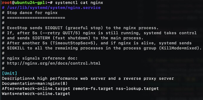

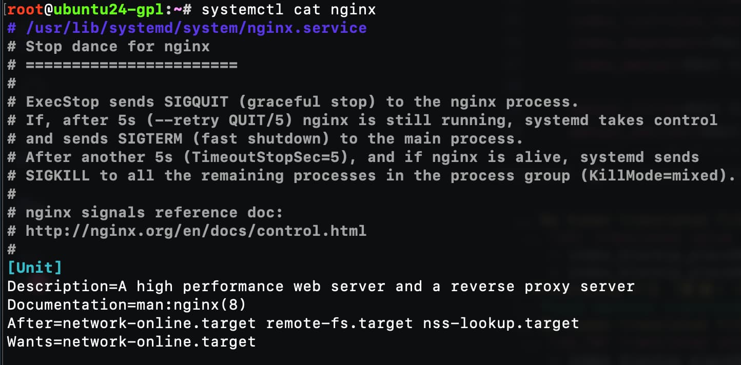

Furthermore, adding network.target won’t really help in the case of an IPv6 network. All contemporary distros, including Debian 12 and Ubuntu 24.04, already have:
[Unit]
After=network-online.target remote-fs.target nss-lookup.target
Wants=network-online.target

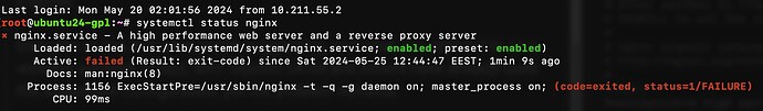

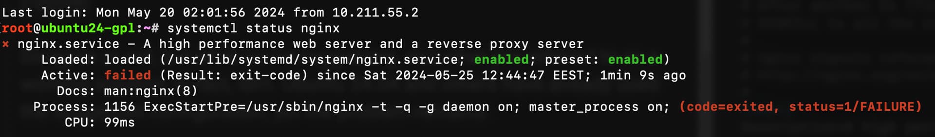

yet Nginx still fails to restart on all the distros I tried, starting with Alma 9 and ending with Ubuntu 24.04.

Disagree or not, but what you’re suggesting, and what you referred to as a working solution, in fact, isn’t. Ubuntu 24.04 and others have already used the suggested configuration, yet the problem remains:
