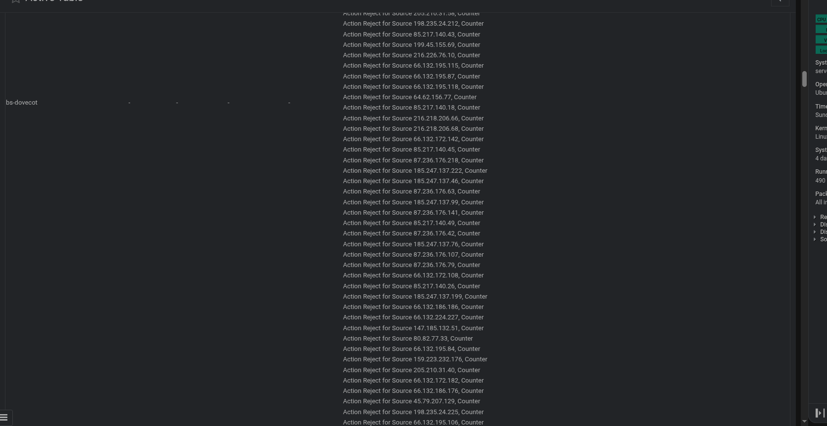

The new module may need a bit more work to convert existing iptables rules, currently nf tables GUI gives me this

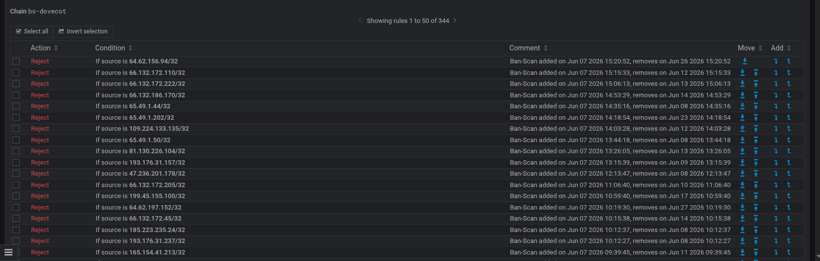

and iptables module gives me this
I really do prefer the iptables module display, it shows comments and is a bit better spread across the screen and shows comments (the new module has comments switched on but does not display them). why when you hover of a chain does the background turn blue for the whole chain ? As far as I am concerned the nf tables module should just be exactly the same as the IP tables module in appearance, but it could be said as you used firewalld as the default for a while the nf tables module looks a bit like the firewalld module and not the iptables module which may suit users that have never seen or used the IP tables module, as I ditched firewalld I use it quite a bit

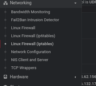

It’s appeared on my system, this may be due to me not having firewalld installed, which I guess most will have installed my network tab looks like this now
note linux firewall is the nf tables module

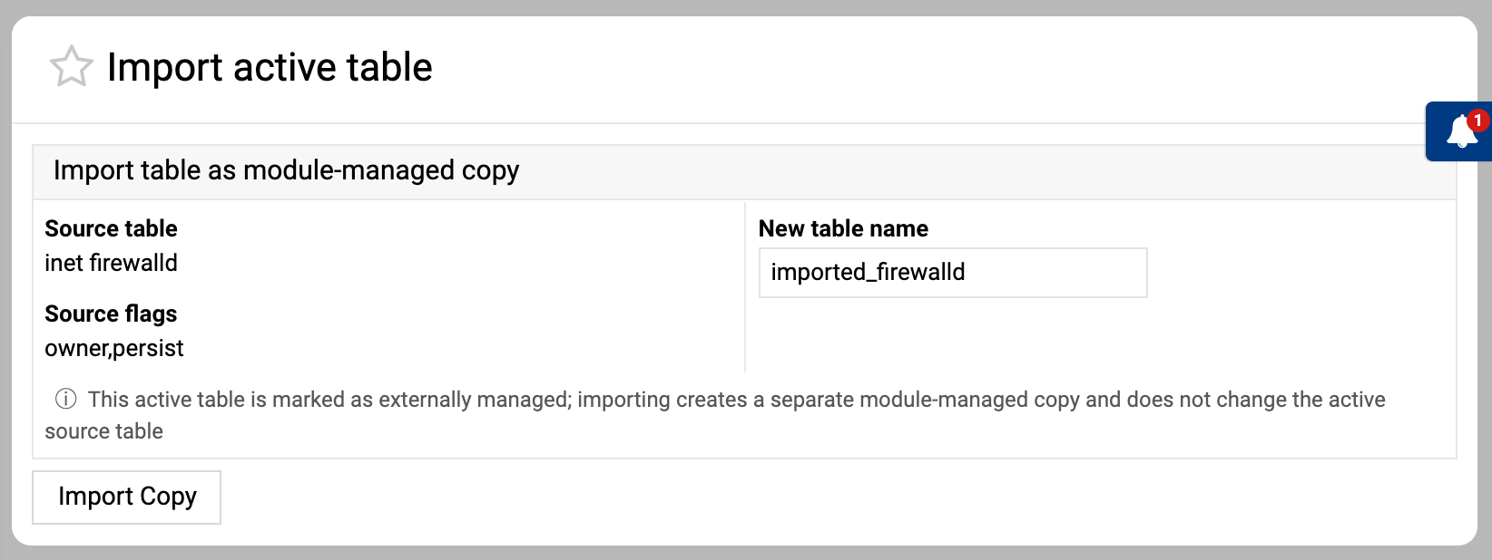

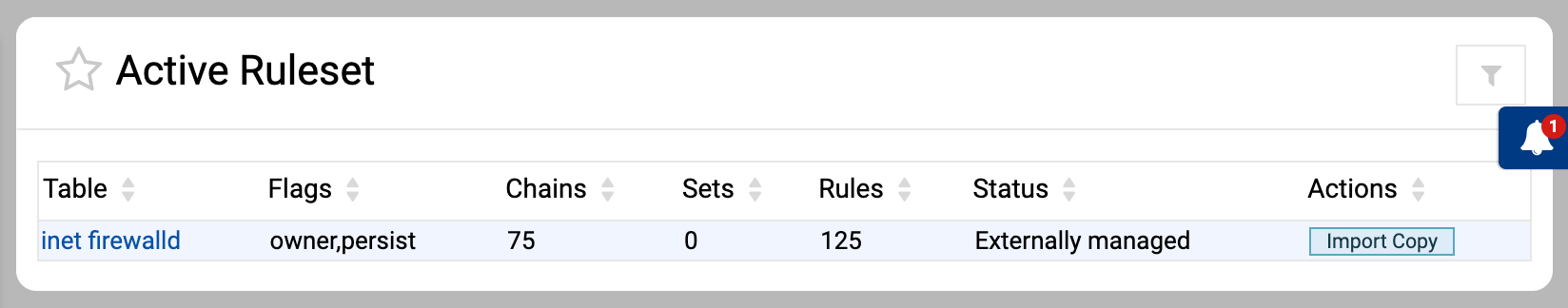

And there’s really no need for that either. The latest version of Webmin nftables module already lets you import a copy of active rule sets.
Just go to the index page, click the “View Active Ruleset” button, then click “Import Copy” for the inet firewalld table (or any other external table you want to import), and that’s all. For example:
