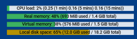

No really running hot. Don’t know what happens.

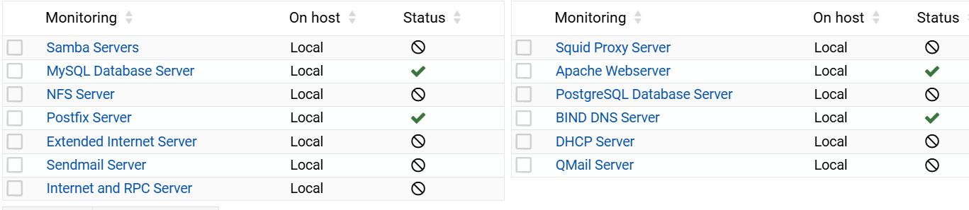

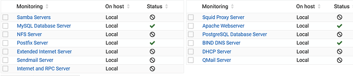

I’ve tried everything under the sun. I stopped anything that I wasn’t using like postFIX and DoveCot. Changed from fail2ban to sshguard. Still get OOM crashes. I look at top and everything looks good then all of a sudden crash. I have a crontab to check if mysql has stopped and restart. Not ideal but I don’t want to sit there and manually check if mysql has stopped as it crashes every 24 hours or so.

It’s a bit hard to decipher. Myql doesn’t restart by systemd as it goes into a loop.
