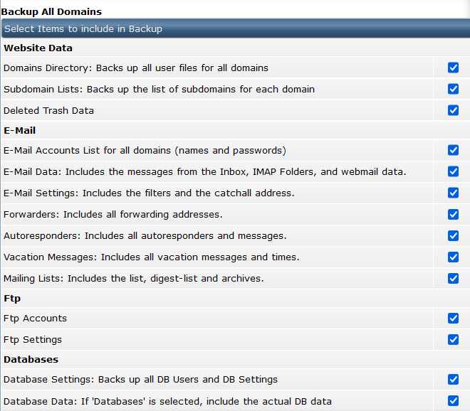

You guys are a few steps ahead of me. Let me be more specific; this is how I generate the backup in DA:
There’s no AWstats installed, only Webalizer although I could care less if this is copied over or not.
I was lead to believe I do NOT have to create a virtualserver first, but I could just go to Migrate Virtualserver and follow the steps @charlesworks was kind enough to lost, apart from installing Webalizer since I still can not find recent documentation howto.

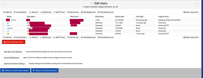

Thanks @charlesworks But I’m afraid I need a bit more details. Changing it to the “Virtualmin user”? Who is the virtualmin user? Until the migration there was no user. Now there’s an owner and a bunch of other users migrated from Direct Admin. It kinda looks like this now:
I changed wp-config to the owner User 1 in this example and it’s password but that didn’t work. I did not expect it to, simply because I assume the database has the opriginal password stored somewhere, that is also in the wp-config file.
However, it does look like the owner User 1 is th eonly one who has Login access to a Databse. So, I would assume the other MySQL users would need that to, and somehow lost that privilage diring migration?

your image does not look correct there are no links to the user account but you could have removed the other columns that are not present. Perhaps edit “User1 OWNER” password to suit what you have in your software config
Indeed I do not have the columns Disk quota, Quota used and last login. I checked other accounts (not migrated ones but made from within virtualmin, and they also lack those columns. I also do not understand why my list of database users do not show Database in the last column called Login Access, but maybe that’s not necessarry. I changed the applicable database user (it’s in my php-config file, so I know the right one) and try to ‘change’ the password to the pw mentioned in the php-config file, still no connection. I seems to be missing more. Maybe my virtualmin install is not complete?
