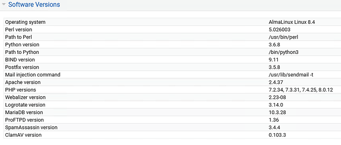

This weekend I have installed a new server, these are the versions of the packages I have installed, I followed the howto of RJM_Web_Design and I find it curious not to have installed the latest versions of the packages, we talk about in some packages 3-6 months of delay, is it normal?

For example, spamassassin the last version its 3.4.6 ( 2021-04-12) , 3.4.4 version installed its from 2020-01-28

Mariadb last version its 10.6.4 August 2021, and i have installed 10.3.28 from February 2021

This is a new install, only for test, the last 10.3 mariadb version its 10.3.31 6 August 2021
I am only search understand because i have installed this old versions, i am not a linux expert and my native language its Spanish :wink:
No. It is not an old version. It is the current version provided by your OS. Don’t go trying to “fix” what is a feature of your OS. RHEL (and thus CentOS and all other RHEL rebuilds) commit to a version at the time the OS is released, and they support that version for the life of the OS, backporting security and some bug fixes, as needed to keep it secure.
This is a feature, not a bug. You can know with an extremely high level of confidence that what anything you build on that OS today will continue to work throughout the life of the OS. If there were changes to the versions of the underlying software, you could no longer have that confidence. Every update could break your apps or your configuration, possibly in subtle ways.
Please don’t start breaking your system by immediately going and upgrading a bunch of stuff with random stuff you found on the internet. You’re not improving your system by doing so, you’re just making you life harder and your system less reliable (and possibly less secure, though in the case of getting packages directly from the upstream provider that’s probably less of an issue).
My recommendation is always, and I mean this emphatically: Do not use third party repos unless you really must have some specific version of something, and you have done the research necessary to understand how the packages from that repo interact with the OS you’re using (i.e. do they replace system packages? do they install in a different path like /opt? do they conflict?). And, be sure you understand that no third party repo will ever have the lifecycle guarantees of the OS itself. If you pick a RHEL rebuild as your OS (CentOS, Alma, Rocky, etc.), presumably the long term stability is a big reason for it. Why screw that up?
