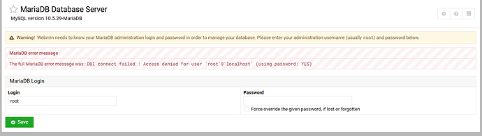

After updating the system with all available updates (it had been about two weeks since the last update), Virtualmin/Webmin are no longer able to connect to the MariaDB database. The same password (the one used by the root user only to connect to MariaDB, and different from the SSH root login password) is still valid for accessing the MySQL root user from the SSH terminal.
To summarize:
Password pasted after running the command:
mysql -u root -p
Access granted.
The same password pasted into the text box shown in the screenshot: Credential error.
Before the update, there were no issues.
I have not tried checking the “Force override the given password, if lost or forgotten” option because I’m afraid it might corrupt the hash and prevent access from the terminal as well.

I periodically update all the server packages. The last time I did it was 21 days ago (I had written two weeks, but I double-checked), and everything was working properly. Today I had about 34 new packages to install, so I performed the update. Afterward, when accessing the MariaDB section, I encountered that error. Simply restarting the service did not produce any positive result.
However, from the terminal I was still able to access the database without any issues. The problem only occurred within Webmin. In the configuration file (/etc/webmin/mysql/config), the password was correct.
At that point, I tried removing those two special characters from the password, updating it both in MySQL and in the configuration file, and it worked.
If you’re telling me that in your code there’s nothing preventing those characters from being used in the password, then it means that the simple update query and the flush privileges command resolved the issue. Since I had removed those two characters, I assumed that was the cause.
Another odd behavior I’ve noticed only since I started using the most recent versions of Webmin/Virtualmin is that when I create a new database user through your tool, even though the user appears and I grant the correct permissions to the proper database, from the application side (my proprietary software) the user is not recognized. To fix it, I have to set the password again via the terminal.
It might even be the same underlying issue, but this is the first time in many years of using Virtualmin that I’ve had a problem with the MySQL root user. The issue with database users needing to be reassigned via the terminal is also recent. Until a few days ago, everything was working correctly.
