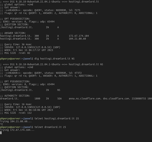

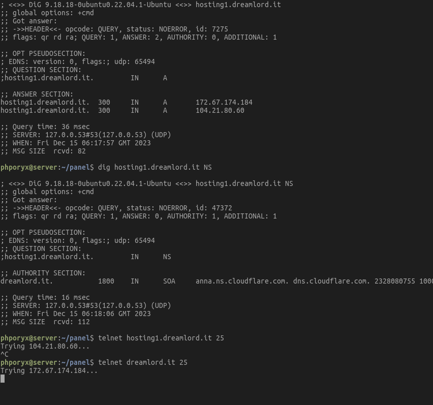

So you’re proxying those records?
Anything mail related should not be proxied. There are some docs on CF regarding this specifically.
I do have a second VPS (older one) and the A record associated to the PTR is proxied. It can send mails to google. I’ll make some tests to see if I can get it work.
I also cannot understand (second issue) why I do not receive mail in the mailboxes.

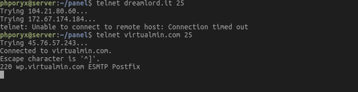

I think you need to be sure you have port 25 available. I see no evidence of it in the logs above.
I mean, you need to test that (incoming and outgoing). Stop guessing.
no port 25 open see here 2 attempts
notice the connection to virtualmin.com works as port 25 is open
No port 25, no mail server.
Dude, why are you even trying to contact CloudFlare on port 25?
Like I mentioned above, records relating to mail can not be proxied, it will never work.
CF Docs here.
@urbaman it’s not about the PTR itself, but rather the A record associated with the MX records for a particular domain.
Dude
didn’t you read
it needs a direct connection or a relay to work
Exactly, but port 25 won’t work through CF.
Which is what I told him earlier, no need to telnet that.
He has outgoing port 25 working on IPv4 which is clear from the logs, IPv6 is another issue…
