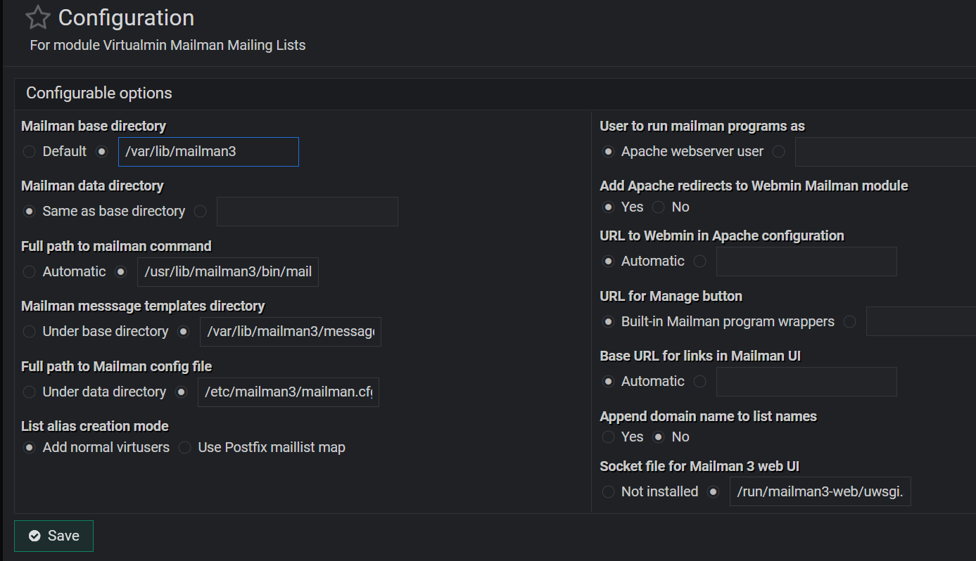

/var/lib/mailman3 has the following folders:
archives cache data lists locks messages queue templates
If you’ve configured it correctly, it can’t be the same error. So, what’s the error now?
It doesn’t have a bin? Then why tell Webmin that’s where the mailman command is? You need to tell it how to find everything or it can’t work.
The bin folder is in /usr/lib/mailman3/bin. In that folder is mailman, master, and runner files. The bin folder is the only folder in /usr/lib/mailman3.
Oh, I see. So, yeah, that should work. What’s the error? Is it really exactly the same error as before?

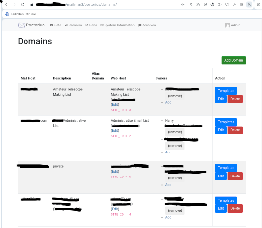

I’m trying to find my notes but Mailman3 uses Django to add domains.
domain.tld/mailman3/postorius/lists/
I think this is all in the database?
Mr. GooAI says there is a shell and you can use python to do the same. I guess this is what the WM/VM interface would do?
so, does that mean Django - only available in Pro ?
I’m just offering up what I remember. I have NO clue how this was implemented in the Mailman module. Like I said, it is data base driven and there is more than one way to stuff a database. Believe me, I suffered mightily through the install.

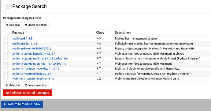

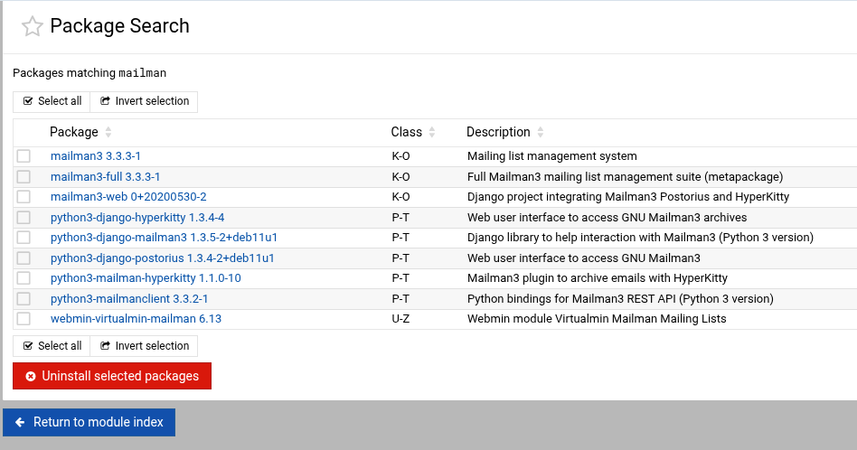

“In order to get the full Mailman3 system, the metapackage ‘mailman3-full’
should be installed.”
That package doesn’t show up in my Debian 13 install. ONE reason I went with Debian 11 was, at the at the time, Ubuntu was waiting on some upstream fix from Debian on that package. I think at the time there were two parts. One was called ‘web’. Just took a screen shot of my D11 machine. You might not even be able to use the web interface I referenced above.
