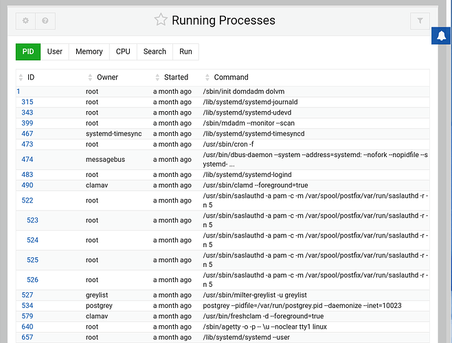

Type “running processes” into your webmin search bar. Default sort is PID so you should be able to find the appropriate process. Then explore the options you are given.

One step at a time. You can manipulate the running process that is locking webmin. I don’t know what that process is. I don’t know if it is safe to simply kill or maybe restart? That you are going to have to determine. But, like I said, one step at a time. If you click on the blue PID (3055 in your case) you will be taken to another page of options.

Well, that will reset a stale PID. :wink: I assumed you didn’t want to do that because you hadn’t done it already.
