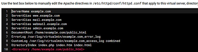

when i am first installing virtualmin, i do so from a script that contains the following:
/usr/bin/sed --in-place --expression='s/^longname=0$/longname=1/;' /etc/webmin/virtual-server/config ;
then my script runs several of these commands:
virtualmin create-domain --domain XX.online --dir --unix --dns --web --ssl --pass passwordHere ;
however, in my /etc/httpd/conf/httpd.conf file, i “lose” the domain name suffix:
    ServerName XX.online
    ServerAlias www.XX.online
    DocumentRoot /home/XX/public_html
    ScriptAlias /cgi-bin/     /home/XX/cgi-bin/
    <Directory /home/XX/public_html>
    <Directory /home/XX/cgi-bin>
notice how some the above lines appears to have lost the domain suffix .online ??

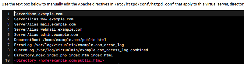

ok this is VERY interesting…
i have two identical domain names, dot-com and dot-info
the dot-com one drops the suffix for these:
ScriptAlias /home/XX/public_html
but then second one (dot-info) is processed as expected, with the domain suffix in place.

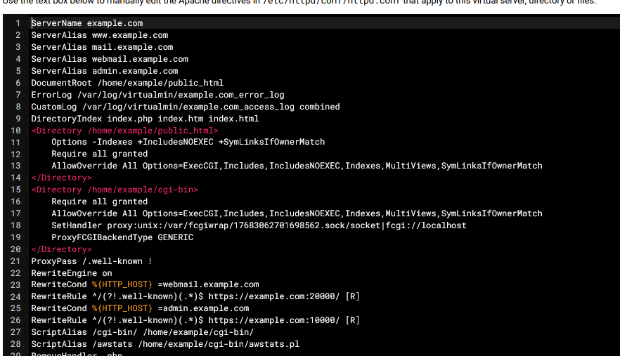

i am having trouble getting this to work.
now i am seeing these filenames (without the domain name suffix)
   DocumentRoot /home/zzzzz/public_html
   ScriptAlias /cgi-bin/ /home/zzzzz/cgi-bin/
   <Directory /home/zzzzz/public_html>

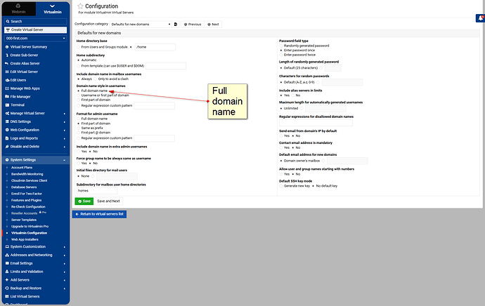

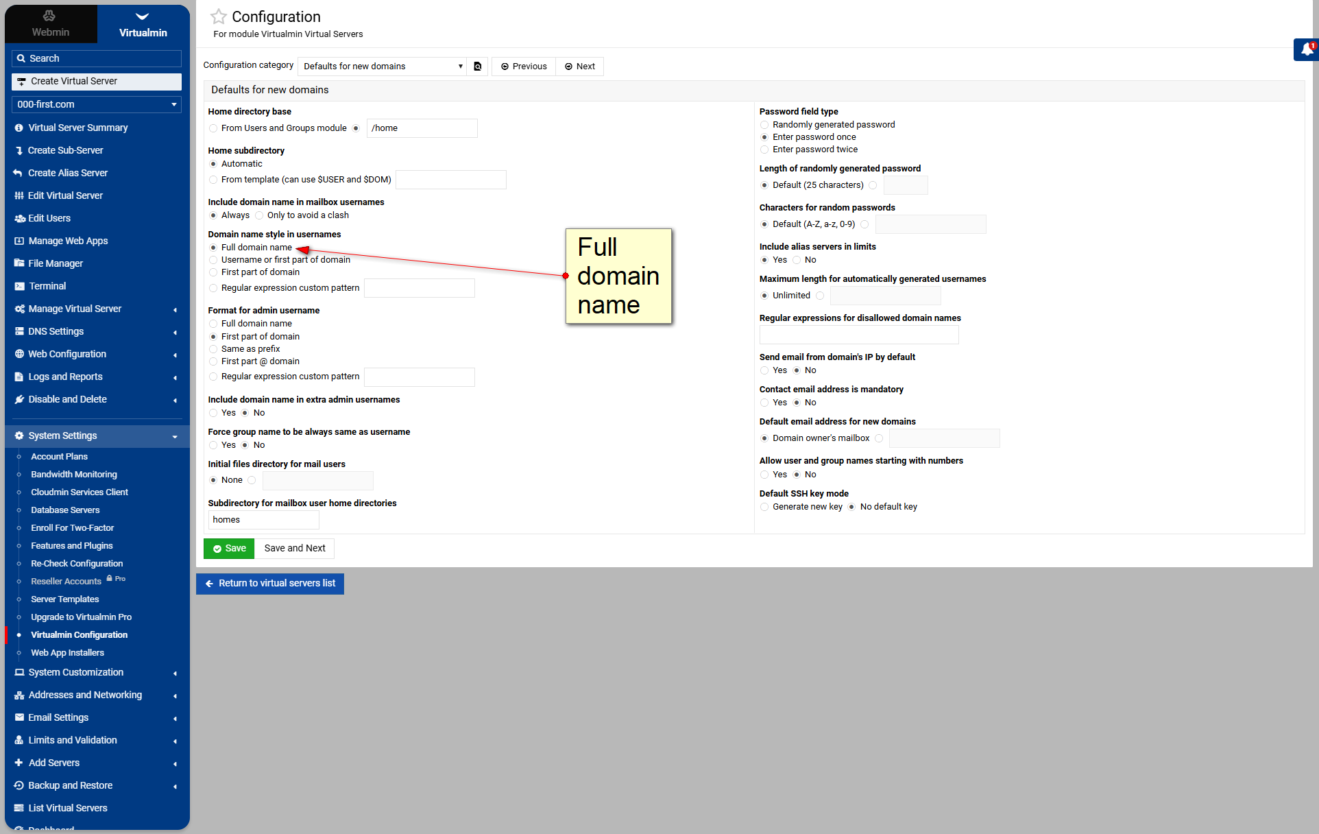

and i have ‘full domain name’ set:
i tried changing the value to “First part of domain” and back again thinking maybe something didnt get set right, but i continue to see the same directory names without the domain name suffix.
its behaves as if the “Full domain name” setting is no longer working.

for 10+ years now, the first thing i do on a new installation is set the "domain name style in username’ to “Full domain name”.
and this gives me the desired result, where the FULL domain name is in the home directory:
/home/virtualmin.com/
however, on the newest installation, this setting seems to be ignored. now i am not seeing the full domain name in the home directory:
/home/virtualmin/
this seems to have started happening just in the past few days.
tomorrow i will try this again (using Google-VM) but i will ONLY install webmin/virtualmin and see if i get the same results.

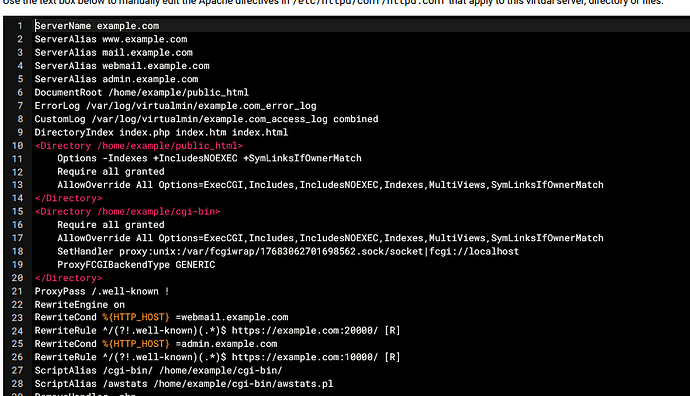

ummmm i think there may be something wrong. Here is what i did this AM:
  1. new Google-VM, rocky-linux
  2. dnf update, etc etc
  3. my FAVORITE command:
sh -c "$(curl -fsSL https://software.virtualmin.dev/virtualmin-install.sh)"  \
                                         --yes                               \
                                         --bundle    LAMP                    \
                                         --branch    stable                  \
                                         --hostname  host.edwardsmark.info   \

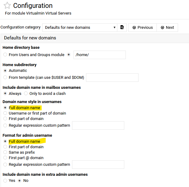

  1. “Domain name styles in username” changed to Full domain name
  2. created VS zzz.com
  3. examined results.
    ServerAlias www.zzz.com
    ServerAlias mail.zzz.com
    ServerAlias webmail.zzz.com
    ServerAlias admin.zzz.com
    DocumentRoot /home/zzz/public_html
# ls  /home/
mark  rsa-key-20221208  zzz
this appears to be easily reproduced.

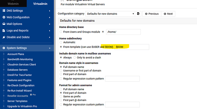

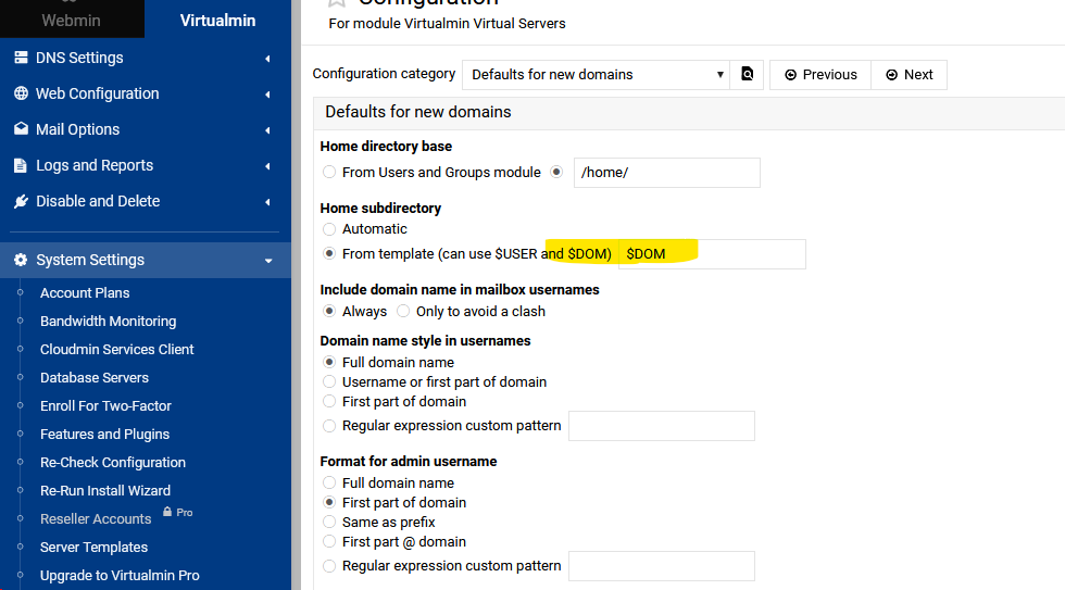

workaround (hopefully):slight_smile:
/usr/bin/sed --in-place --expression='s/^longname=0$/longname=1/;'  /etc/webmin/virtual-server/config    ;   ## 2025-02-17
echo  'home_format=$DOM'  >>   /etc/webmin/virtual-server/config    ;   ## 2026-03-03
i will test this out. full credit goes to stefan1959 for his excellent suggestion.
EDIT: this appears to be an acceptable workaround.
