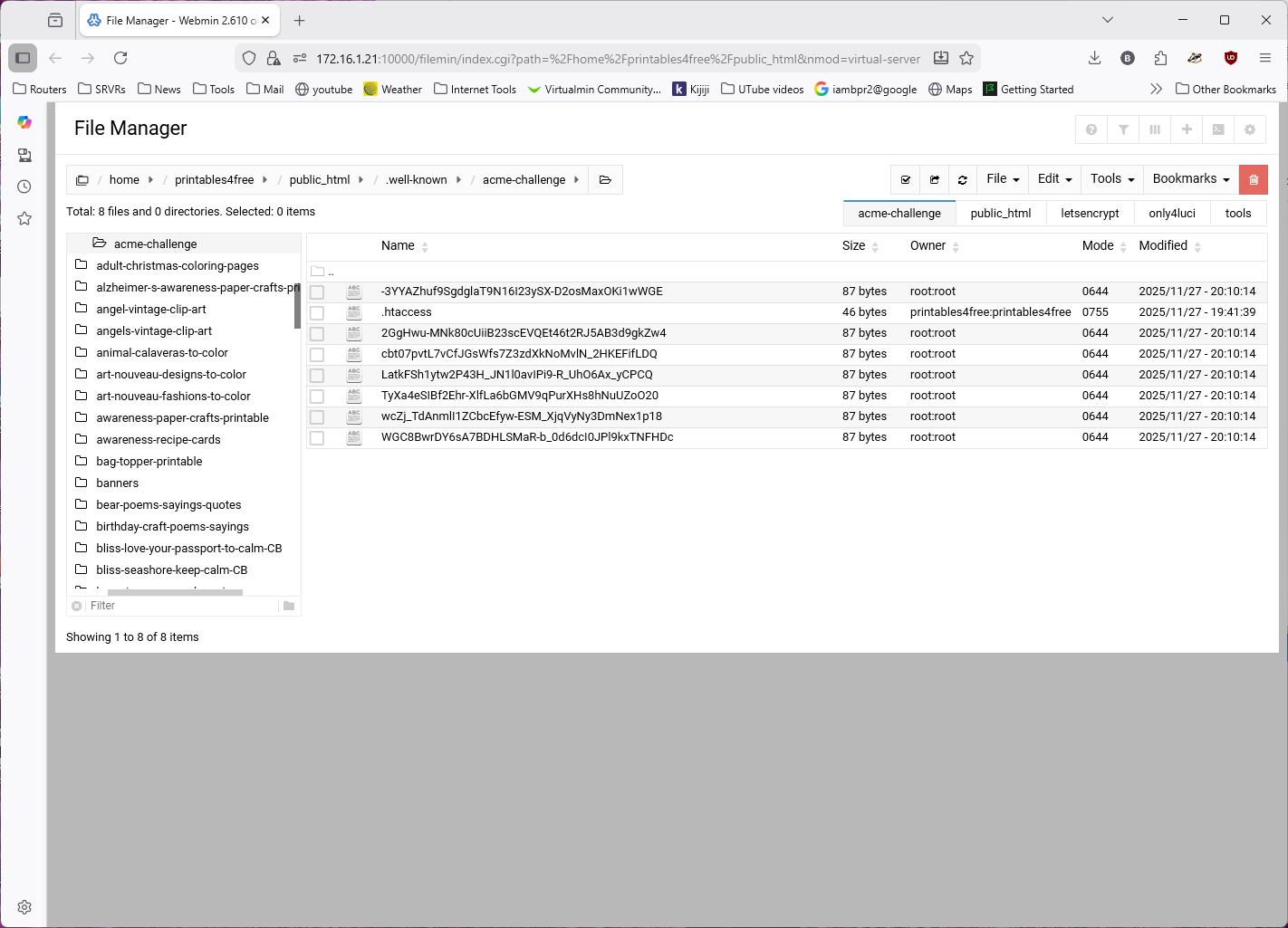

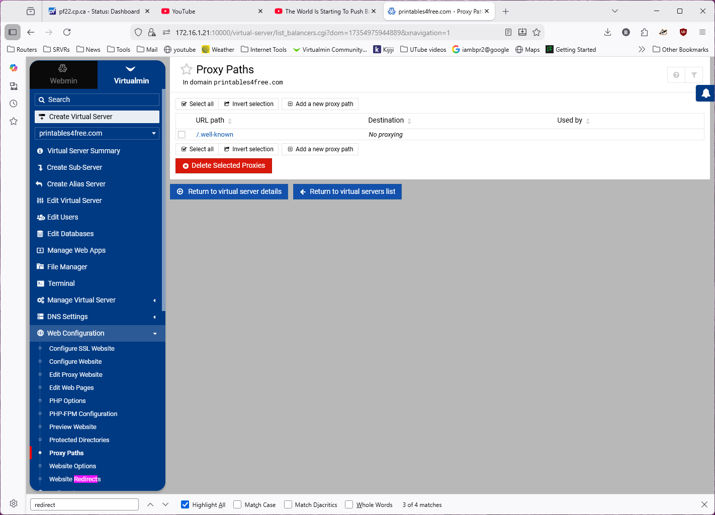

Thats a clue, by the forum at LE you redirecting to a IP address, “LE doesn’t support redirecting to an IP”.
Check here
Thank you for this clue … not sure what to do with it yet, but it does help. Neither of the two domains that now have this problem have been modified for almost a year, neither has the server been modified other than regular Ubuntu & Virtualmin updates … however one of the other domains has been going through significant re-writes and has implemented a few re-directs with HTML updates … I’ll look at the possibility that one of those went into the wrong domain files.
Put a file in .well-known and browse to the URL. There’s no need to guess about what’s happening.
The URL will be: http://youdomain.tld/.well-known/the-file-name
If you can’t browse to the file you created in .well-known, Let’s Encrypt can’t validate, and you need to fix that. According to the error, you’re redirecting somewhere, so you need to not do that for .well-known.
Exactly this. Create a small script to see what the url does or use a simple tool like: https://www.redirect-checker.org/
Worst case scenario you got some virus, but most likely there is some wrong rewriterule in .htaccess or something.

I did create the folders: /.well-known and /.well-known/acme-challenge … and put JPG file in each and was able to get a browser to display the images.
I did also look at the apache logs and confirm that letsencrypt actually is getting a a RC 301 when attempting to GET the hashed txt file that cerbot successfully created on the server.

  5. found a setting re: proxy that I do not understand, wonder if it has something to do with the problem (another image)

BTW there is an .htaccess file added into the .werll-known/acme-challenge folder … but it only appears to be intended to overlay any other .htaccess file that might have been leftover in this folder … it simply has an ‘allow all’ line.
