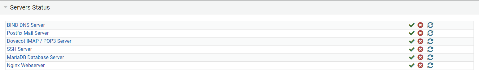

Thanks, but I have always used the Dashboard to check:
Always worth checking though
