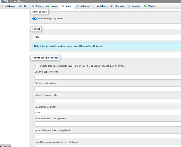

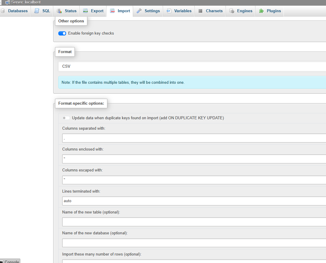

The myphpadmin app can import a csv file, maybe see if you have any luck with that

as indicated above by @stefan1959 I would have used the myphpadmin app (also can export a csv file)

I don’t think I ever used phpmyadmin. Only MySql Workbench or terminal. In the past i have worked extensively with MSSql, I even hold a MCP on the 2005 version, it’s a more mature product which so far Microsoft wasn’t able to ruin :joy:.
