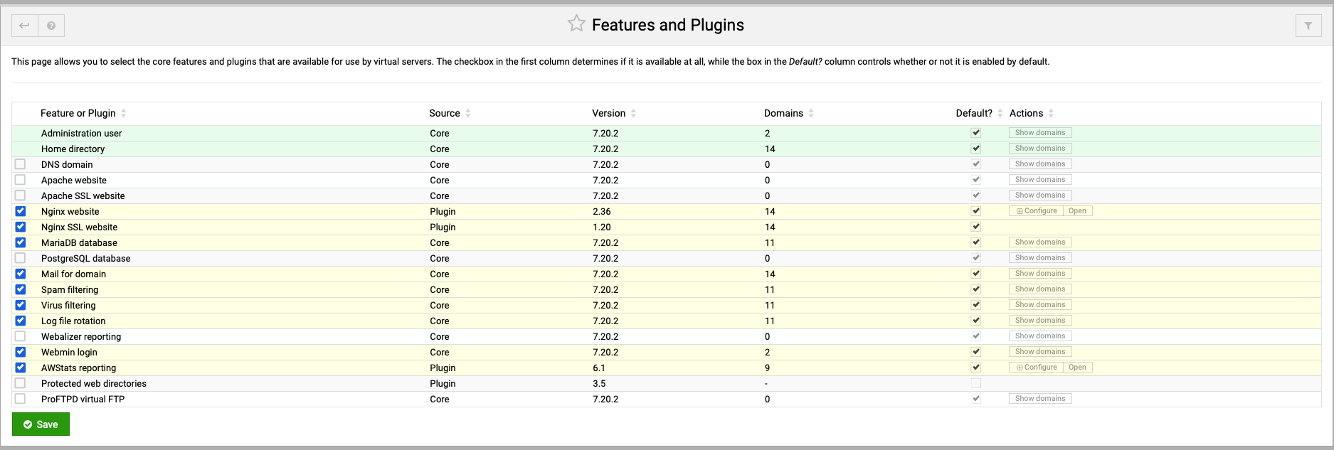

also listed here unchecked but still, and if it should not coexist with NGINX why is it shown at all?
As has been mentioned history and probably most folk expect it. As long as it is not checked and if you need a webserver either or nginx or apache is checked
so I am in the clear then?
Apache support is built-in. It can’t be removed from Virtualmin (at least not without a bunch of code changes). nginx is a plugin. nginx support can be removed by removing a couple packages, Apache support cannot. But, if it’s disabled, it’s not doing anything.
It is maybe bug-like that selecting nginx and de-selecting Apache doesn’t make Virtualmin use nginx. But, maybe you were misinterpreting what you were seeing before and it was actually already doing the right thing? Was the reason you thought it wasn’t right just because you saw Apache in Featurs and Plugins or was Virtualmin actually still trying to make changes in the Apache configuration instead of nginx and showing the status of Apache rather than nginx service? I’m trying to figure out if there’s something we need to fix, or merely something we ought to try to document better.

Having made the decision to install via the LEMP option and then seeing Apache is disconcerting (especially to someone who detests Apache) but after a while one gets used to it as a quirk.
given the number of times this question (can we install both webservers) seems to pop up perhaps it could be better handled/displayed? Documentation - perhaps (but who reads that? when? - would it be simpler just to not show Apache in the list when the alternative has been selected?

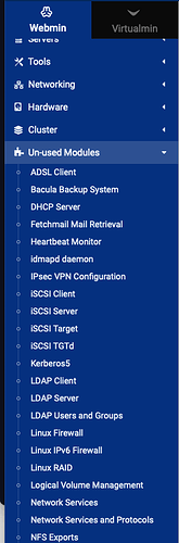

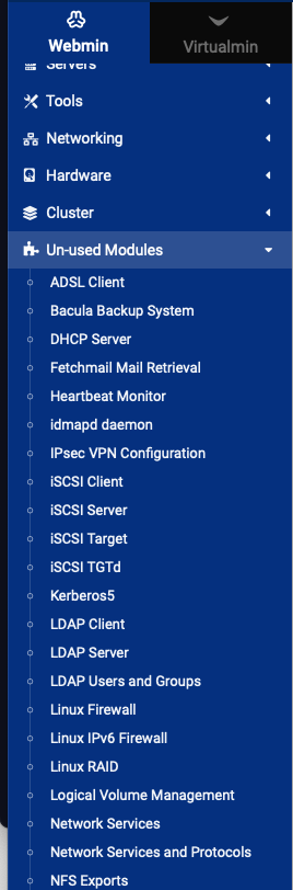

Alright, folks, I’ve got a squeaky clean LEMP setup! Now, I could totally go ahead and install Apache again by diving into the unused modules and smashing that install button… but hey, I’m not that crazy. Just kidding, haha!
